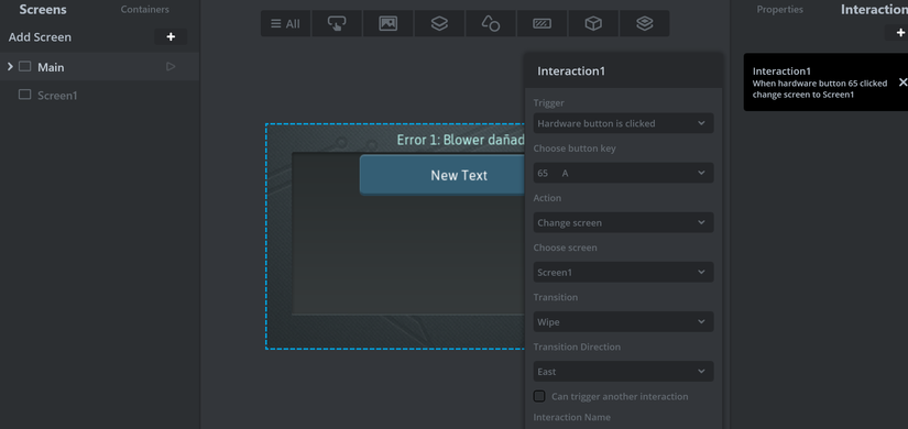

Ohh boy zero info... Try this
run simultor and press A key on keyboard Work transition ?
Interaction1 in my example is add on main screen (FYI your screen marked to start) and transition go to Screen1...
When this works ok you can step to physical button code ...

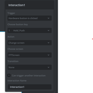

Button setup in TouchGFX:
This is the cpp file as created in the youtube video provided by STM.

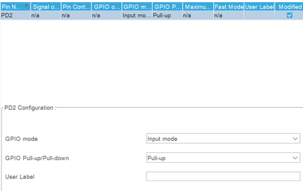

And here is how the button is configured in the ioc file:
Thanks again,

Hi, thanks for the response.
I have checked my StartUpScreenViewBAse.cpp file and it appears to have generated correctly.
void StartUpScreenViewBase::handleKeyEvent(uint8_t key)
    if(1 == key)
        //Interaction1
        //When hardware button 1 clicked change screen to FFTScreen
        //Go to FFTScreen with no screen transition
        application().gotoFFTScreenScreenNoTransition();
Is it that I need to call "application().gotoFFTScreenScreenNoTransition();" from another place in my code?

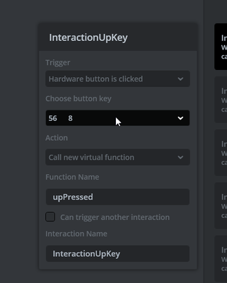

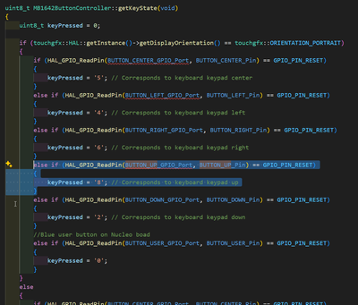

We provide examples of boards and UI using hardware buttons with the GFX01M2 display extension.
One of the GUI using hardware button is the "Aircon remote demo":
Instead of adding a hardware button to TouchGFX Designer (which is possible), we mapped it to a keyboard key.
This way, we can execute an interaction from pressing a key on the keyboard (when simulating for instance) and we are also able to map our physical button to execute the interaction.
Here you can see that the interaction is executed when pressing the key '8' :
And here you can see how we mapped the hardware button to a key in MB1642ButtonController.cpp :
I hope this example is helpful to you!

I manage it in model tick, TGFX examples with key is long way ...
Try in model.cpp
void Model::tick() {
	if (HAL_GPIO your button test == SET) {
         //wait for release add here
		static_cast<FrontendApplication*>(Application::getInstance())->handleKeyEvent(
				'A'); // here use key from my window example
good is add inteligent key handler release this is only example. Positive is this send event A key to actual screen , and this can handle different reactions on different screens.  All is setup in designer.
And your second Q transition with delay you can setup in designer. Not require any code in main or while.
Learn use Interactions, here for example exist action wait for ...
