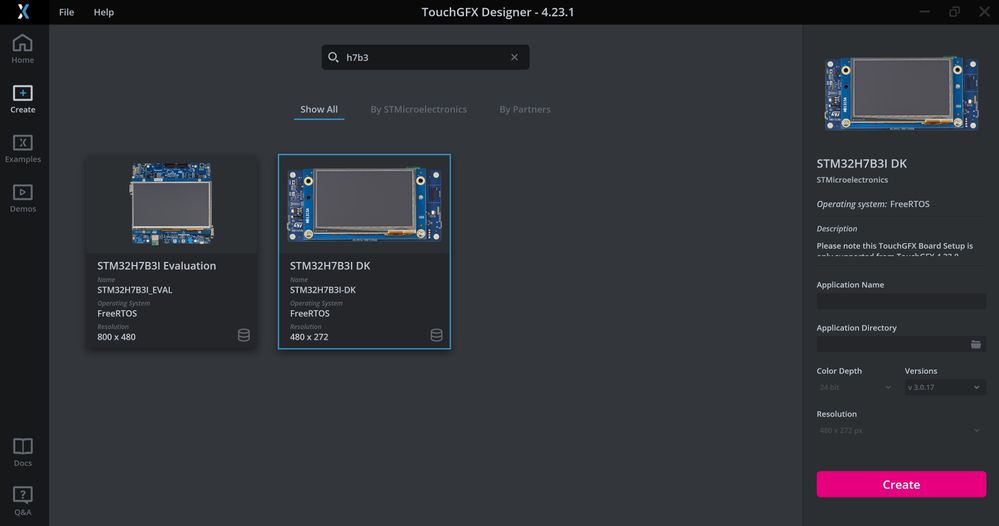

Hello @Ayoub_Bnina ,
Yes, as you mentioned the problem arises from touchgfx_init() not being able to access the text table stored in octospi memory. So, by following @KDJEM.1 's guidance and fixing your octospi, you should be able to run TouchGFX easily.
Keep in mind that, there is already a Board Setup for STM32H7B3I-DK available on TouchGFX Designer that you can simply use to develop your GUI.
STM32H7B3I-DK Board SetupSTM32H7B3I-DK Board Setup
And to answer your question about the size of the framebuffer, you cannot decrease the size of the framebuffer because it is based on the resolution of the display and the pixel format that is based on. So, for the mentioned Board Setup, it would be 480*272 * 2(16 bpp) bytes
