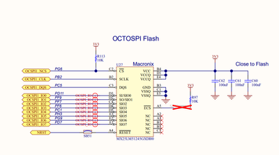

Hi Community, I am encountering an unexpected white blank screen issue in my TouchGFX application after configuring the GPIO pins for OCTOSPI1 peripherals. The application was previously functioning correctly, but the problem arose after making changes related to OCTOSPI1 GPIO configuration. I am reaching out to the community to seek assistance in diagnosing and resolving this issue.
Following the configuration of GPIO pins for the OCTOSPI1 peripherals, my TouchGFX application now displays a white blank screen upon starting the FreeRTOS kernel (`osKernelStart()`). This unexpected behavior indicates a problem with display initialization or rendering, potentially caused by the recent GPIO configuration changes.
I am using the STM32H7B3I-DK development board and have developed a TouchGFX application with FreeRTOS. The application was functioning correctly before the OCTOSPI1 GPIO configuration changes were made.

Hello @Ayoub_Bnina ,
If I remember well, you use STM32H7B3-DK board? Which board revision are you using? B02, C01....?
Please refer to the board schematic and check the OCTOSPI GPIO pin needed for the OCTOSPI1 configuration.
I hope this help you!

Ayoub_Bnina
Thank you @KDJEM.1, That was the issue,  I correctly fixed GPIO configuration, also I was using Micron not Macronix Memory Type.
