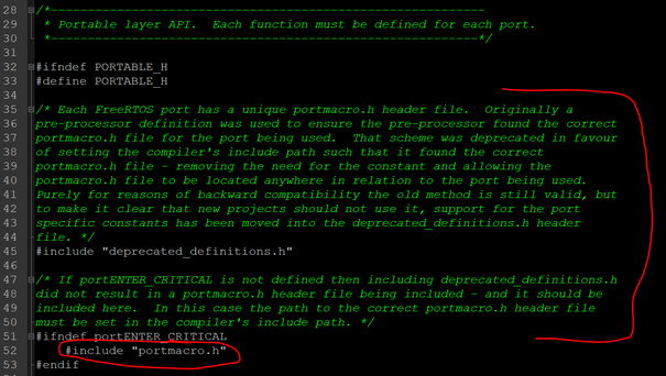

2024-01-30 5:01 AM
> "Is it actually missing, or is the compiler just not finding it?"
I am not sure. This is what portable.h says on line 52:
There are 2 portmacros.h in the project:
DynamicGraph\Middlewares\Third_Party\FreeRTOS\Source\portable\IAR\ARM_CM7\r0p1\portmacro.h
DynamicGraph\gcc\Middlewares\Third_Party\FreeRTOS\Source\portable\GCC\ARM_CM7\r0p1\portmacro.h
Should there be a portmacro.h for Keil toolchain perhaps ?

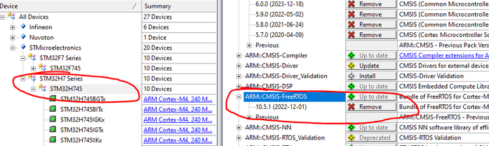

2024-01-30 7:07 AM
Thank you @Andrew Neil
1. Install FreeRTOS package from Keil Package installer
2. copy files port.c and portmacro.h from
c:\Users\<user>\AppData\Local\Arm\Packs\ARM\CMSIS-FreeRTOS\10.5.1\Source\portable\RVDS\ARM_CM7\r0p1\
into
STM32F746G-DISCO\Applications\DynamicGraph\Middlewares\Third_Party\FreeRTOS\Source\portable\RVDS\ARM_CM7\r0p1\
Files available here as well:
https://github.com/ARM-software/CMSIS-FreeRTOS/tree/main/Source/portable/RVDS/ARM_CM7/r0p1
