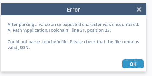

I am trying to upgrade Touchgfx 4.18 to 4.21.3. I know I have to update and regenerate the code from STM32CubeIde and from Touchgfx Designer. Howerver once I regenerate the code form STM32CubeIde I can no longer open the .application.touchgfx file. As this error appears:

  • I can no longer open the .touchgfx file with 4.23.3

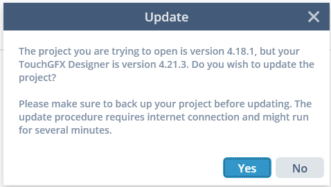

  • The update popup appears and I accept
  • The update process failt with the same message and I can no longer open the file

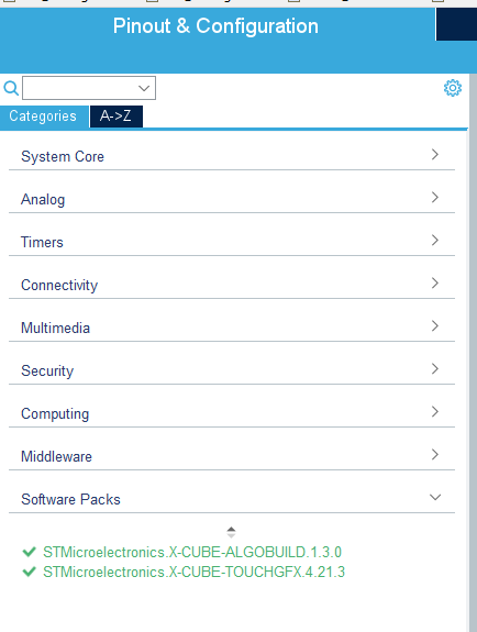

0693W00000aPMuPQAW.pngStep 5 I can see that the SW package is selected correctly in th .ioc
0693W00000aPMvDQAW.pngStep 6 I click ok, save the .ioc and the code is generated.  I can see that files in TouchGFX/target/generated have been created by touchgfx version 4.21.3 : "This file is generated by TouchGFX Generator 4.21.3. Please, do not edit! "
Step 7: I try to open the .touchgfx file with the designer:
0693W00000aPMvXQAW.pngAfter clicking yes it fails with the "Application.Toolchain" error
