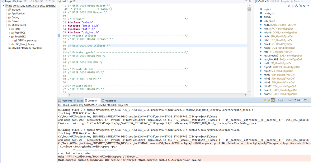

There were few differences between F429 and F746 discovery boards, like I had to use SPI2 instead of SPI5.
But MX created the code without any warning. But when do clean and  a build, I get following build error and it gets terminated.
C:/TouchGFXProjects/my_SW4STM32_STM32F746_DISC-project2/Middlewares/ST/TouchGFX/touchgfx/os/OSWrappers.cpp:1:10: fatal error: touchgfx/hal/OSWrappers.hpp: No such file or directory
#include <touchgfx/hal/OSWrappers.hpp>
compilation terminated.
make: *** [Middlewares/TouchGFX/OSWrappers.o] Error 1
Middlewares/TouchGFX/subdir.mk:18: recipe for target 'Middlewares/TouchGFX/OSWrappers.o' failed
10:57:47 Build Finished (took 5s.982ms)
Following is the build screen. Please let me know how to fix this issue.
Thanks
Kiran

Hi @KMunj​ ,
Please have a look at [yourproject property]-[C/C++ Build]-[Settings]-[Tool Settings]-[C++ Compiler]-[Directories].
Compare it with [C Compiler]-[Directories].Try to find out if any of these [Include Path] is miss.
