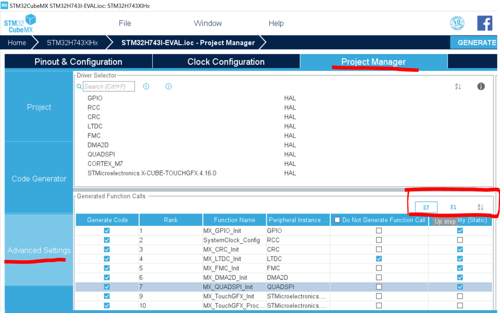

In CubeMx, Project Manager tab -> Advanced Settings, the "Do Not Generate Function Call" for MX_TouchGFX_Init is not working.
After selecting it and generating the code, the MX_TouchGFX_Init() is still present in the main.c and going back to the Advanced Settings, the previously selected check box got deselected.
This is a problem because when using the QuadSpi with TouchGFx, it needs to be mapped before TouchGFX initialization.

‎2021-01-20 6:12 AM
Thank you for reporting this. I am surprised by it as well as I could replicate the issue on projects on a STM32H743 eval board and on a H7b3 dk board. It seems that only the MX_TouchGFX_Init is not working, we will investigate more on that (might be just me not aware of a step to do). Could you add the topic "CubeMX" in the Topic tags of this post ? That way this will have more visibility.
Are you working on a custom board ? Did you start your project from scratch from CubeMX ? I am asking this because from what I understand from your message, you have the MX_TouchGFX_Init called before the MX_QUADSPI_Init ? This is not the case in the application template for the H743 eval board available on TouchGFX Designer. I believe the issue might come in your case from the "rank order" of your functions: you can see that in the Project Manager tab -> Advanced Settings --> Generated Function Calls. You can change the ranks of the function by selecting a function and pressing the "up or low arrows" on the top right (see picture)

‎2021-01-20 6:33 AM
Hi Romain,
Thanks for the answer.
(CubeMX is now added to the topic).
Yes, I am working on a custom board, starting from scratch with CubeMX.
The MX_TouchGFX_Init is indeed called after the MX_QUADSPI_Init.
However, the bit of code to map the QSPI must be after MX_QUADSPI_Init and before MX_TouchGFX_Init.
The best place to add this code would be at the end of the MX_QUADSPI_Init function, but this is not possible because there is no "user code" section there.
What I have done now (and is working) is that I selected the "Do Not Generate Function Call" for the QSPI instead and moved the call to a user code section earlier in the main ("USER CODE BEGIN SysInit"). Then I do the QSPI mapping.
