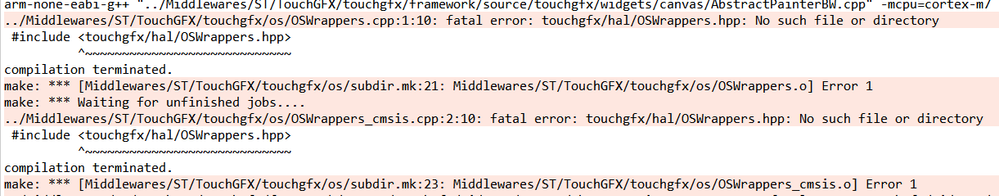

I am using CubeIDE 1.0.2 and when I go to build the project (after executing TouchGFX, at about 5:30 of your youtube video) CubeIDE never finishes.

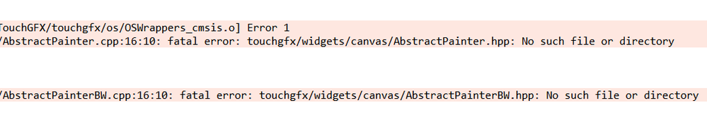

I need to kill it and it prompts to save the cubeMX file. I do this, reopen the project and build it and I get different errors than you do in your video. The errors I get have to do with OSWrappers and AbstractPainter.
Any idea what may be causing these?
One thing to note is that the simulator files appear to be already excluded from the build so that step appears to be unnecessary. Is this something that was added to version 1.0.2?
I finally got a new project to compile on STM32CubeIDE (1.0.2). One MUST follow Martin's video EXACTLY. One thing that I did not see in the video is that he closes TouchGFX after designing the screens and doing a "Generate Code". I had not seen that and left TouchGFX open. This messed up STMCubeIDE to the point it needed to be killed via Task Manager. Of course, it was not closed cleanly and this must have caused issues.

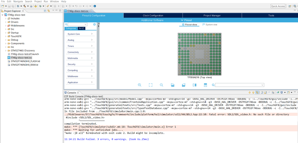

Hi Martin
It complies fine when I migrate it to CubeIDE. I am getting the following error once I compile after opening f746g-disco-test.ioc file to make changes to configuration. It asks me to migrate and I click yes. Compile straight away without making any change and it throws these errors. I am on version 1.0.2 of the IDE.
Any ideas?
Thanks

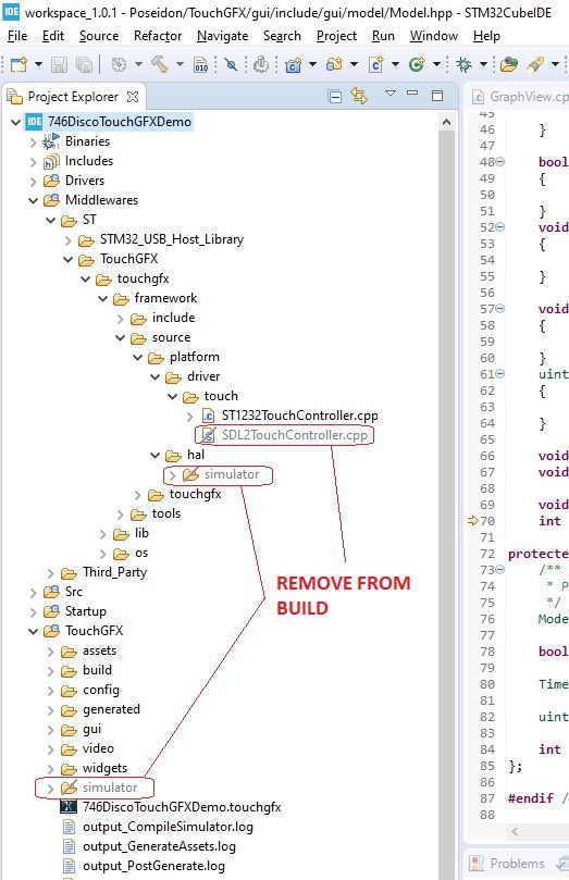

Hi @zul-a​ ,
as shown in the video I think you must remove some files and directorie from project build.
This does not always work. I have gotten STM32CubeIDE into a state where even when selecting some items to "Exclude Resource from build", it will still fail to compile because it still attempts to include them (even after explicitly telling it not to).
What I have done to alleviate this problem is edit the actual project file (as mentioned previously in this thread). A good idea is to keep the project in a repository (I use SVN) and restore some of the changes that have been altered as a result of a STMCubeMX code generation.
