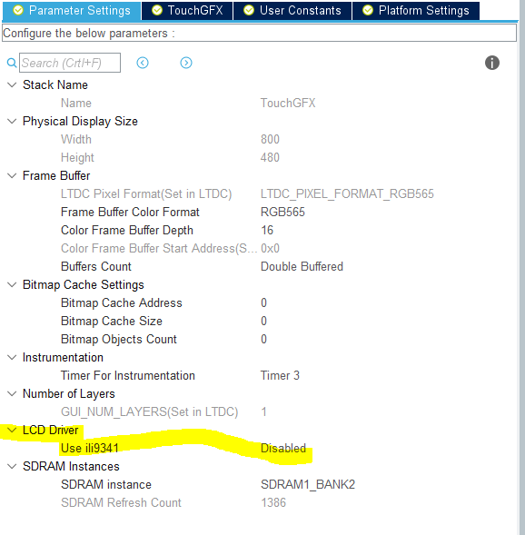

I am using STM32F429IGT6 microcontroller, Cube IDE Version: 1.0.2, and TouchGFX 4.10.0
I have configured all peripherals as shown in your example, but the TouchGFX option is not coming active
Attatching the project, Please check whether I have done anything wrong

I got it correct and compiled successfully , I missed enabling some interrupts as in your example.

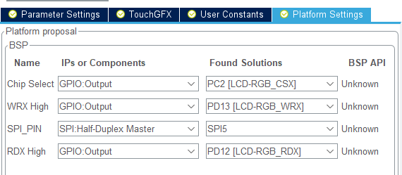

  1. I am using an LCD without controller (800*480) connected to LTDC. Disabled ILI 9346 in TouchGFX Parameter. Am I correct ?
  2. Even after that the system is asking to specify other pins and SPI which are not in my LCD (platform settings). Will it cause any issues ?; I am yet to test it on hardware.
