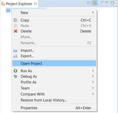

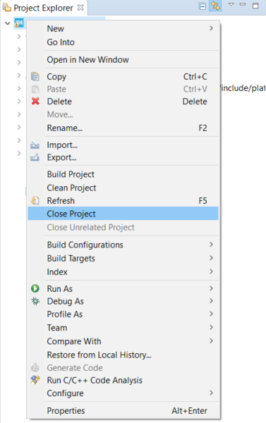

Hi Martin,
I've had the same errors as above from regenerating the code in the CubeIDE/CubeMx configuration tool.
I found a simple solution that seems to fix the issue for me:
After regenerating from the configuration tool, in CubeIDE, if you close the project on the workspace then reopen it (as shown in screenshots), it seems to build and flash without errors.
Hope this helps!
