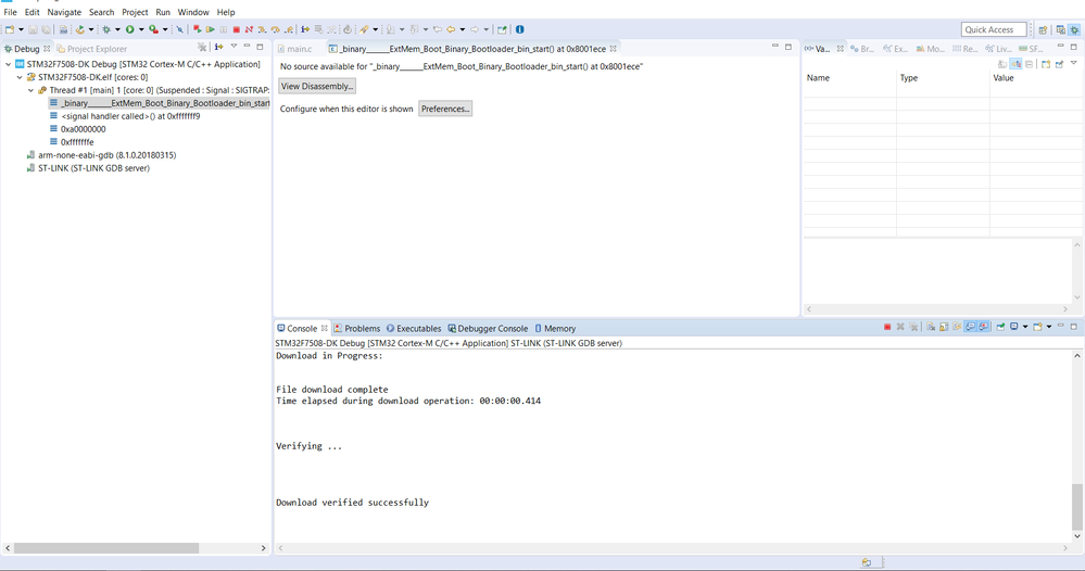

I had success in creating and debugging a blinky project when created from cube IDE, but not using touchgfx generated project for this board
I am not able to start a debugging session for project created by touchgfx.
Things I have tried:
1.Explicitly changing to "External loader" from "Debug configuration" corresponding to this board
To recreate this issue:
  1. Create touchgfx project for STM32F7508-DK from touchgfx designer 4.14.0
  2. Add simple button or screen and "Generate code"
  3. Browse or import autogenerated "STM32CubeIDE" folder and open project in cubeIDE
  4. Build and debug as "STM32 M-Cortex C/C++ Application"
  5. Wait till target download and click "Resume"
As "Resume" is clicked in debug perspective, after a few seconds the following state is encountered (image) and board stays in blank state forever (LCD white)

First of all, thank you very much for being complete in your request. It happens so rarely that it is extremely appreciated :)
Your step 4 [Build and debug as "STM32 M-Cortex C/C++ Application"] could be the issue. Are you sure you are using the .stldr file when downloading into the board.
To confirm, you could use CubeProgrammer and download into the board selecting the right board and see if it works. Also downloading by clicking on Run Target in the Designer could help to see if the issue comes from CubeIDE.

I have concluded that the issue comes form the IDE. Please download and see the attached short videos. I have created them to clearly convey the issue to you.
Video description
video 1 Run target for touchGFX, flashing succeeded, Auto reset [OK]
video 2 flash from cubeProgrammer, flashing succeeded, Auto reset [OK]
video 3 Flash for "Debug as STM32 . . ." option, flash succeeded, No auto reset but needed manual USB disconnect and reconnect. In addition to this, there was debug launch error [NEED SOLUTION]
This is the main issue I am facing.
Ideally when I start debugging, the following should happen:
  1. Firmware must get downloaded to board [OK till here]
  2. Board must auto reset after download complete and debug must halt at main() [Halts at main() but reset FAILS]
  3. Further on clicking "Resume" debug should start and screen will be presented on board [FAILS, instead need manual USB unplug and plug and shows some error related to ExtMem_Boot_Binary]

So I created from touchgfx designer, the readymade template to work further. This case did not cause any flash overflow and build also succeeded. But debugging is really an issue. I saw a new folder created by touchgfx generator named "ExtMem_Boot" in project root dir ( ExtMem_Boot APPLICABLE ONLY FOR STM32F7508-DK ONLY)
On opening this folder, I found a readme.txt file. I strongly recommend you to read it. Summary: This is special Firmware developed by ST MCD Application Team to overcome the limitation of low flash capacity devices.
It is my guess that this is interfering with the normal debug launch. I am saying this because the error statement during debug fail "No source available for "_binary_______ExtMem_Boot_Binary_Bootloader_bin_start() at 0x8001ece" shows some relation with the folder "ExtMem_Boot"
Since I have just began working with STM32 platform, This is all I could conclude and provide to you
I request you to resolve any of the above case with this board or if possible, recreate at your end before resolving
Thanks,
Eshwar
You are right, indeed it is currently not possible to debug.
"This is special Firmware developed by ST MCD Application Team to overcome the limitation of low flash capacity devices" so we are not aware of what they did exactly for this part.
FYI, the F750-DK has such small Flash (we consider it Flash-less) that the code needs to be stored in external Flash, therefore outside the MCU.
We will try to investigate and see if we can come up with a workaround.
