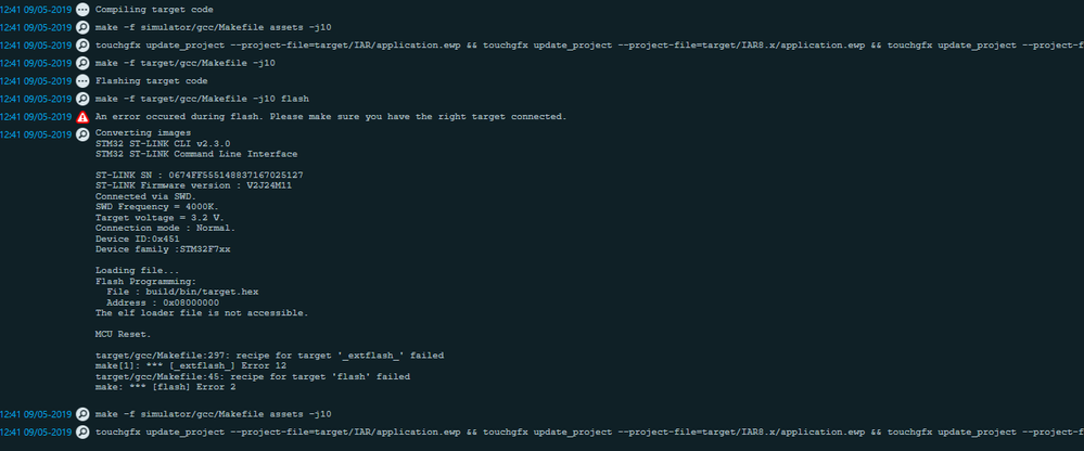

I am trying to run a clock demo from TouchGFX 4.10.0 Designer for my STM32F769-DISCO.
But when i Run on target the detailed log shows the erroe:" there is an error occured during flash. Please make sure you have the right target connected."
PS:I am sure that i have choose the right target.

Can you please try updating your ST-Link? It seems your installation is quite old. ST-Link_CLI.exe is on v3.3.0.
Ca you try connecting through the ST-Link GUI, not in TouchGFX Designer.

‎2019-05-09 4:11 AM
Make sure you have a microUSB cable connected in the ST-Link connector, start up ST-Link and connect and post the results here (TouchGFX designer uses ST-Link to program boards).
‎2019-05-09 4:46 AM
Hi @Martin KJELDSEN​ this is a screenshot of the error
PS: I run the clock demo successfully on STM32F746NG
‎2019-05-09 4:52 AM
‎2019-05-09 6:08 AM
I updated ST-link_CLI.exe on v3.4.0 and all the demos runs perfectly.
Thank you very much for your help.:smiling_face_with_heart_eyes:

You're welcome! Sometimes the firmware version of the ST-Link utility is incompatible with the firmware version in the ST-link chip on the board.
