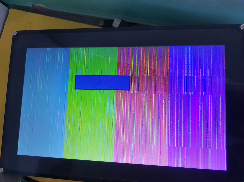

hi friends..
i have configured custome LDTC touch Display for STM32F746IGT controller. I have refferd the following video for configuration:
https://www.youtube.com/watch?v=SRQD8JMeg_k
i have done every thing step by step according to that video and made changes according to my 1024x600 wave share display properties.
after completiing the configurations and cearting GUI in touchGFX im not getting anything on touch Display..
im sharing my project file also ... if some one finding mistakes in my configuration ... pleaz help me to correct it ..

When i commented mx_quadspi_int() .. now its displaying one button that i configured in touchgfx but still background is not coming ...
Through this button i toggled one led also ... and LED is getting toggled without any issue.
i​ think this background issue is coming during fetching the background from memory
Might be im missing something 樂

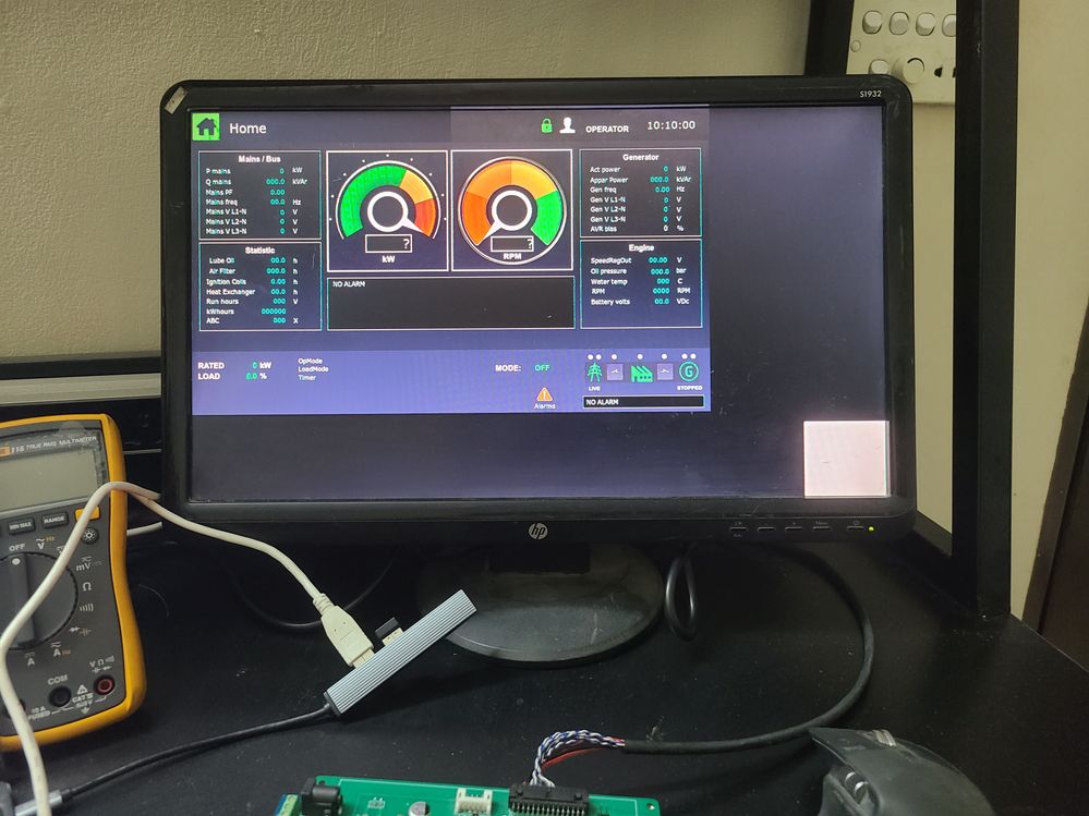

Here is TouchGFX running on HP S1932 18.5" Monitor's LVDS LCD with 1366x768 resolution .
The lcd part no. is LTM185AT04 or Equivalent . The driver is stm32f429i-discovery + sn75lvds83b  

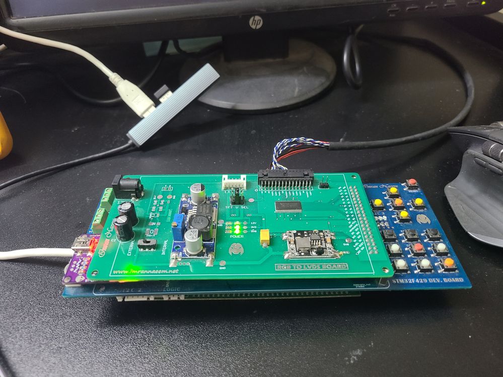

_legacyfs_online_stmicro_images_0693W00000dDV59QAG.pngI made custom board for lvds type lcds ..
_legacyfs_online_stmicro_images_0693W00000dDUzSQAW.pngSorry about dust on my work , the weather is too hot now a days ..
