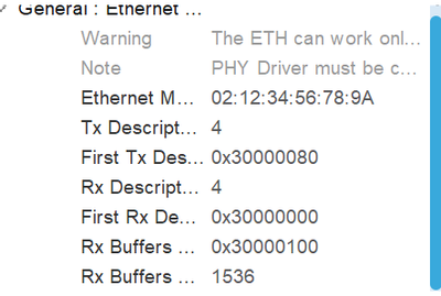

I'm encountering a networking issue where my STM32 device that is NUCLEO-H755ZI-Q, configured with the LwIP stack over Ethernet without FreeRTOS and assigned a static IP address (192.168.100.123), is unable to be discovered or pinged from a PC connected via Wi-Fi to the same router. The Ethernet link is physically active and UP, and the router indicates that data is being transmitted to the STM32, yet it shows almost No receiving packets from STM32 (onto the router). The router don't show the the static IP i assigned to the STM32 as well. I opened my router page to look inside these data. Debug logs from the STM32 reveal that ARP requests are being sent repeatedly and that the IP configuration is correctly set on the interface. Occasionally, the STM32 receives and parses ARP frames, but they are not directed to it, indicating that the receive path is at least partially functional. When using DHCP, the STM32 successfully constructs and broadcasts DHCP discovery packets, yet no DHCP offers are received, resulting in timeouts and retransmissions. Throughout this process, the device does not appear in the router’s device list or ARP table.

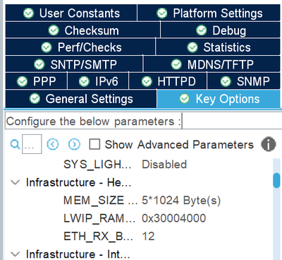

Zainulabedeen_0-1750504442703.pngZainulabedeen_1-1750504469903.pngZainulabedeen_2-1750504552112.png

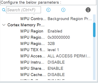

I have enabled the MPU and also edited the flash linker script.

Ok, i got it working without RTOS. I removed the RTOS part from the example and started comparing it my own code.
What got it working was i changed the timebase of M7 core to timer 6 from systick and then i set the priority of systick interrupt to 15 from 0.
Before that i was getting mem of pbuf failed to allocate 60 byte but after changing just the timebase to Timer 6 and setting priority of systick from 15 to 0 on M7 everything started working. Any idea how are they even linked?

@Zainulabedeen You could compare your configuration with the one posted in this thread. It might be as simple as an incorrect MPU configuration or insufficient heap memory size. Ensure you review the adjustments made by the user that enabled the example to work on the NUCLEO-H755ZI-Q:
To improve visibility of answered topics, please click 'Accept as Solution' on the reply that resolved your issue or answered your question.
I just cloned the git, changed the IP from lwip.c file and it started to work. It appears i was configuring the MPU a bit wrong too. However, when i tried to configure everything the same as in the example without RTOS, ethernet, MPU and lwip. It still didn't work.

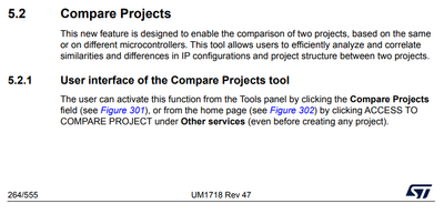

You can use a feature in STM32CubeMX that allows you to compare two projects by providing their .ioc files. This tool gives you a side-by-side comparative view of the configurations, which can help identify differences between the project provided in STM32_Hotspot and your project. It might help you spot any configuration mismatches causing the issue.

@STackPointer64 wrote:
You can use a feature in STM32CubeMX that allows you to compare two projects by providing their .ioc files. .
Ooh - a new feature!
https://www.st.com/resource/en/user_manual/um1718-stm32cubemx-for-stm32-configuration-and-initialization-c-code-generation-stmicroelectronics.pdf#page=264
Appears to have been added in 6.13.0 ?
#CubeMXCompareProjects #CompareIOC
