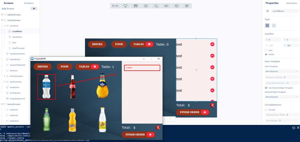

I need help how to add new customcontainer to scrollwheel dynamically.
First I created customcontainer named MenuElement, add TextArea named textItem and Button named buttonRemove to it.
Second I add to screen (menuScreen) scrollwheel element with propertis : Number of elements = 0 and Initial Selected Item = -1, ItemTemplate = MenuElement.
In code I want when button is clicked to call function(interaction to call new virtual function) which will add new item(MenuElement) to scrollwheel and set it to next index of existing MenuElements in scrollwheel.
