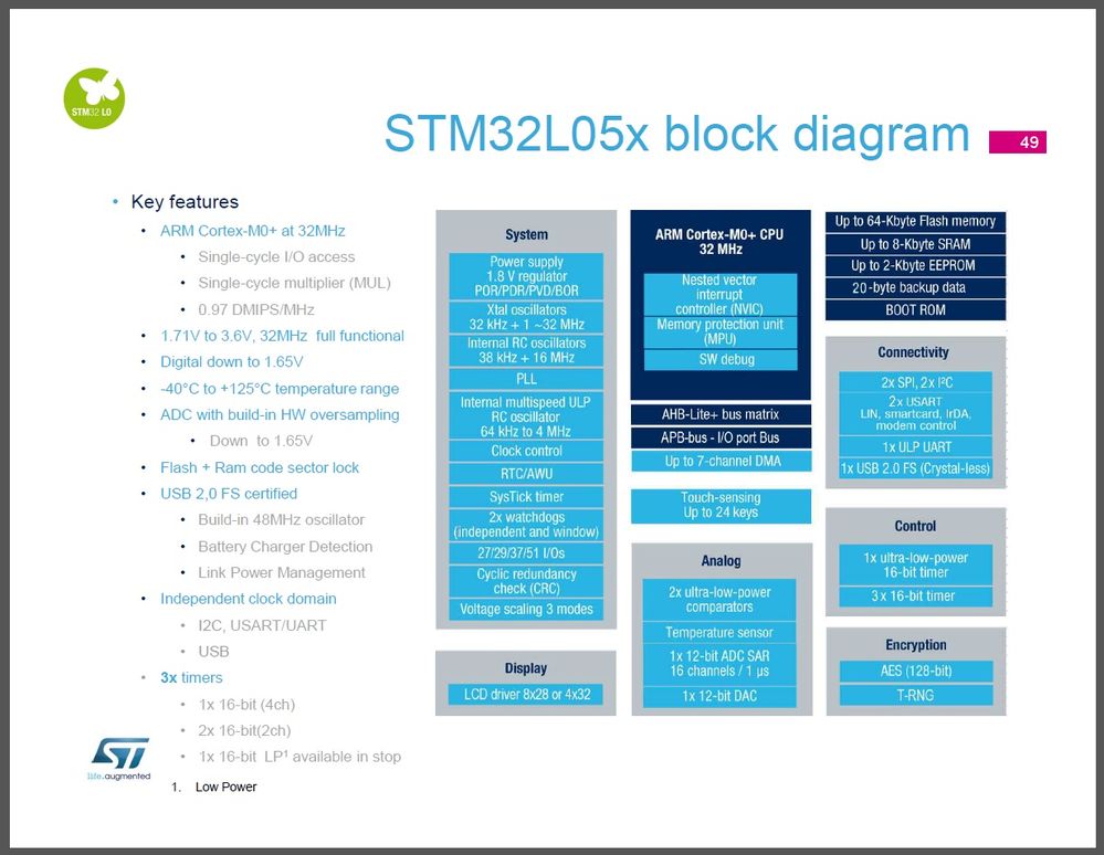

In some ST documents the STM32L0X1 is listed as having an RNG peripheral and older versions of the CMSIS headers list the RNG register addresses. Moreover, enabling the peripheral and using it appears to generate random numbers. However newer manuals and CMSIS headers appear to have removed references to the RNG. What's the situation?

I've got a couple of docs where I'd say this is ambiguously / broadly stated, or internally inconsistent. The intractable numbering methodology leads to a lot of confusion, and miss / over statement of functionality.
I have this in docs from 2014 and 2016

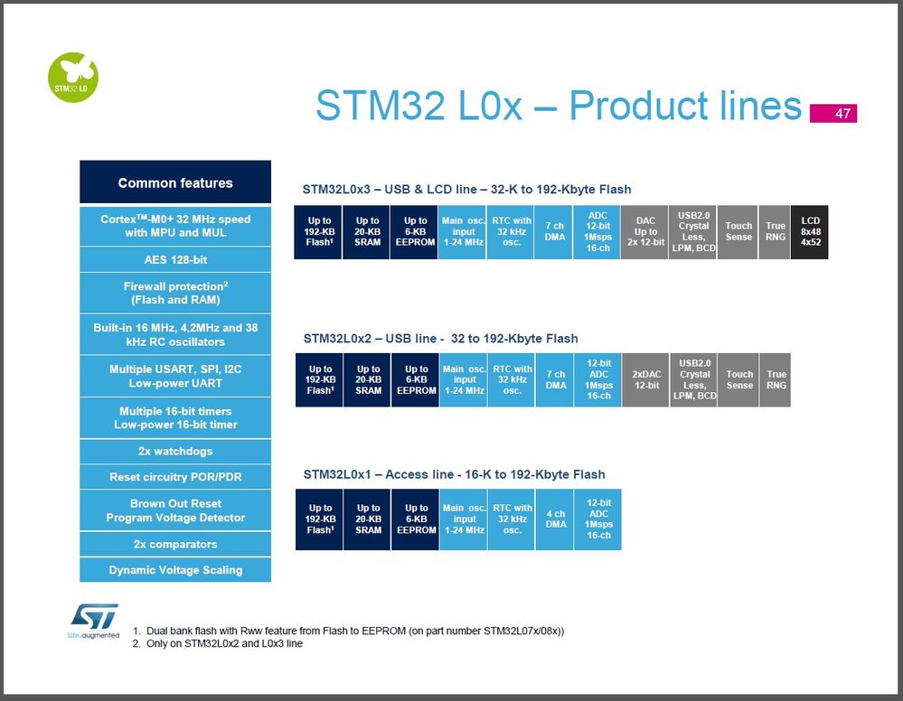

0693W00000WIZVSQA5.jpg0693W00000WIZXsQAP.jpgI don't find any DS or RM for the "Access Line" parts indicating T-RNG
As I mentioned in my response to Amel, the STM32L05x is specifically called out in the App Note that discusses RNG (AN4230). In that app note, where they wish to refer to specific sub-components rather than a family, they spell them out rather than using the 'x'. For example:

It doesn't matter at this point, Amel and Peter have answered my question: the ST32L051 does not contain the RNG peripheral, or at least cannot be relied on to contain it. Unfortunately for us, the components used in our prototypes and pilot production appear to contain the peripheral, but as Peter described, this is likely a case of packaging/labeling 052 wafer parts as 051: perfectly legitimate, but not something that can be counted on for subsequent production runs.
