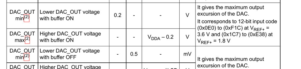

there is no "issue" , the DAC doing , what it should do; if you would read the ds, you could see:
And this you see , when DAC data = 0 .
> Is ~0.05 V at DAC output a known/expected behavior for STM32F4 DAC or specifically on the STM32F4DISCOVERY board?
As you could see from ds : yes.
> What is the best recommended method to guarantee a true 0 V level at the output for such a sensitive current-mapping circuit?
Many ways possible , but the obvious and probably most time used way to go :
your (analog) circuit needs to add some offset , so the DAC output is a little bit shifted;
maybe this : add some negative offset in the voltage -> current amp, so a DAC value of 100 giving zero current.
And same on top: a value for max.level is 4000 , not 4095 .
So you get a clean and predictable output from zero to max , with DAC values 100 to 4000.

You have the Output Buffer enabled, so Yes the voltage is normal and can only be reduced by disabling the Output Buffer, but then You have to buffer the DAC output by yourself (DAC output impedance max. 15 kOhm!).
