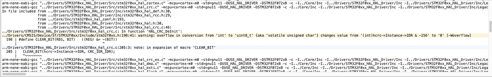

Warning in HAL CRC since updating to F0 Cube v1.11.3
MattKefford
The clear_bit macro in the CMSIS driver is causing a warning when used in the function HAL_CRC_DeInit:
The CLEAR_BIT macro usually deals with 32-bit registers, but CRC_IDR is 8 bit. So even as  CRC_IDR_IDR is cast to uint8_t, operator ~ promotes it back to signed int.
The best solution IMHO is replace CLEAR_BIT to simple assignment:
hcrc->Instance->IDR = 0;
You can post a bug report on ST's github.

It's generally better to copy & paste as text rather than an image

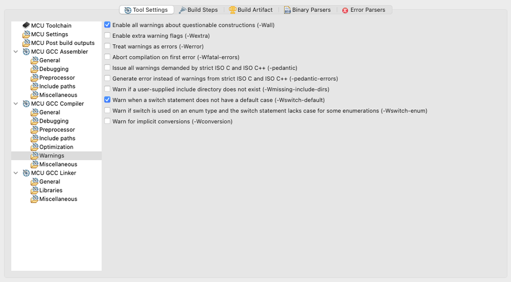

I have had a look at my project settings and there's no option to turn -Woverflow on or off:
0693W00000QKZo5QAH.pngI could deselect -Wall in this settings window but I would like to know about warnings really. If it's something in my code that could cause a bug.
So it seems I would have to add the pre-processor instructions:
#pragma GCC diagnostic push
#pragma GCC diagnostic ignored "-Woverflow"
// ... offending code here ...
#pragma GCC diagnostic pop
But I can't add this as it's in the HAL code and will be overwritten/removed next time I generate the project with CubeMX.
Here's the text from the screenshot if any ST people need it:
../Drivers/STM32F0xx_HAL_Driver/Src/stm32f0xx_hal_crc.c: In function 'HAL_CRC_DeInit':
../Drivers/CMSIS/Device/ST/STM32F0xx/Include/stm32f0xx.h:198:41: warning: overflow in conversion from 'int' to 'uint8_t' {aka 'volatile unsigned char'} changes value from '(int)hcrc->Instance->IDR & -256' to '0' [-Woverflow]
 198 | #define CLEAR_BIT(REG, BIT)  ((REG) &= ~(BIT))
../Drivers/STM32F0xx_HAL_Driver/Src/stm32f0xx_hal_crc.c:205:3: note: in expansion of macro 'CLEAR_BIT'
 205 |  CLEAR_BIT(hcrc->Instance->IDR, CRC_IDR_IDR);
