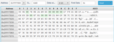

You can see from my last screenshot that you can indeed read OTP while RDP is set to level 1.

I think the only thing worth noting then is that with RDP level 1, the OTP memory is still accessible for read via STLink
I will change the title of this thread to indicate that and I'll test on a few more units; if I can't reproduce the problem, I'll mark this closed.
The issue turned out to be errata 2.2.3 combined with a bad component that was preventing the workaround (disable  nBOOT_SEL in the option bits).
It turns out the OTP is expected to have read access under RDP level 1.
I think that's very undesirable and hope ST will change this in the future since OTP is the perfect place to store things like encryption keys, serial numbers, etc.

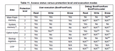

The table below is from RM0454 Rev 2:

I have doubts about the OTP lock and start a separate thread to ask ST for comment, as it is a separate problem from this (btw. have a look at the table you've posted, in the newest revision of RM0454 - it differs exactly in this detail).

Hello @DAlbe.3 ,
I confirm OTP value can be read in RDP1 on STM32G0. I checked on few different G0 part numbers.
I will raise the point internally to get the RM fixed.

Thank you Jocelyn. There are probably multiple documents that need correction; for example, see slide 8 here:
https://www.st.com/content/ccc/resource/training/technical/product_training/group0/68/e5/5c/b5/40/10/43/22/STM32G0-Security-Memories-Protections-MEMPROTECT/files/STM32G0-Security-Memories-Protections-MEMPROTECT.pdf/_jcr_content/translations/en.STM32G0-Security-Memories-Protections-MEMPROTECT.pdf
If there is ever a silicon revision of the STM32G0, I think it would be better to make the silicon match the documentation and protect OTP when RDP is set to readout protection level 1.  I can think of very few cases where the current behavior is what developers would desire or expect.  OTP would be dramatically more useful if you could secure data stored there.
