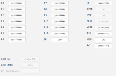

Interestingly, I was able to connect using an STLinkV2 under SoftwareReset.
From the STM32CubeProgrammer, I can perform a core or hardware or software reset, but it always lands back  in the above configuration.  I can access the registers, and read OTP (flash is protected with level 1) so if there's something worth looking at, suggestions are welcome!

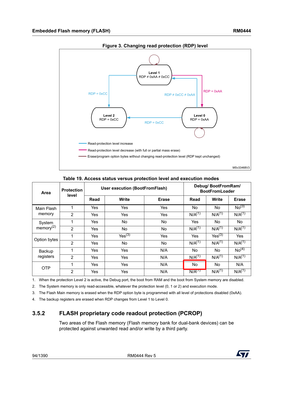

Ugh, I also just found that RDP level 1 does not protect the OTP from read access (at least not when using the STLink).

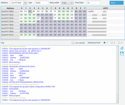

Some progress!
It seems that STM32CubeProgrammer is not successfully setting the nBOOT_SEL bit.
It claims it does:
11:30:31 : Option byte command : -ob nBOOT_SEL=1
11:30:31 : PROGRAMMING OPTION BYTES AREA ...
11:30:31 : Bank : 0x00
11:30:31 : Address : 0x40022020
11:30:31 : Size : 108 Bytes
11:30:31 : Reconnecting...
11:30:32 : Reconnected !
11:30:32 : UPLOADING OPTION BYTES DATA ...
11:30:32 : Bank : 0x00
11:30:32 : Address : 0x40022020
11:30:32 : Size : 108 Bytes
11:30:32 : Bank : 0x01
11:30:32 : Address : 0x40022080
11:30:32 : Size : 4 Bytes
11:30:32 : OPTION BYTE PROGRAMMING VERIFICATION:
11:30:32 : Option Bytes successfully programmed
11:30:32 : Time elapsed during option Bytes configuration: 00:00:01.215

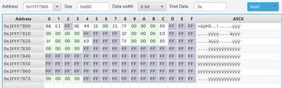

And reading back the option bytes region shows the bit set,
but after power cycle and re-reading the option bytes, you can see that nBOOT_SEL (bit 24) is not set!

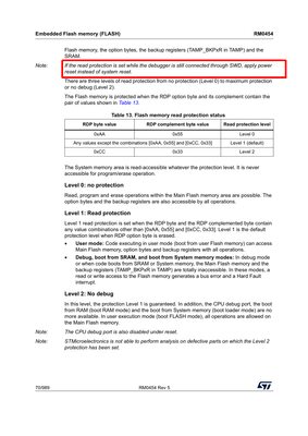

It turns out the OTP is expected to have read access under RDP level 1.
I think that's very undesirable and hope ST will change this in the future since OTP is the perfect place to store things like encryption keys, serial numbers, etc.
The table below is from RM0454 Rev 2:
