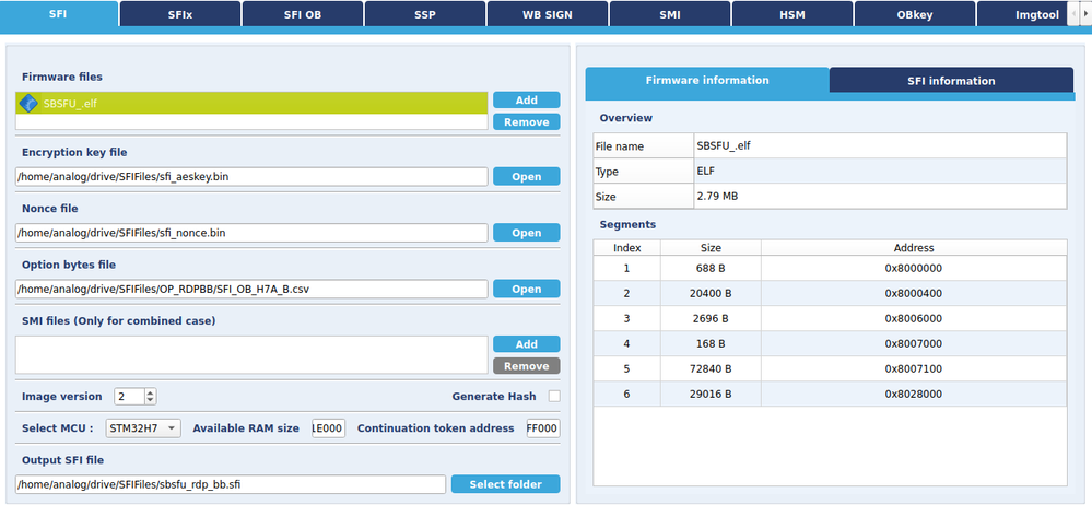

When trying to program SFI file to device getting below error
Error: SECURITY State Fail
Error: Invalid state after SFI install !
Error: RSS internal system error or License is invalid !
SFI creation :
onFull logs:
./STM32_Programmer_CLI -c port=swd mode=HOTPLUG -sfi protocol=static /home/analog/drive/SFIFiles/sbsfu_rdp_bb.sfi hsm=1 slot=1

2022-06-10 6:19 AM
the problem comes from the compability of SFI with your board . STM32H7A/B are not yet compatible with SFI.
The STM32H7A3xI/G, STM32H7B0xB and STM32H7B3xI device errata mention this incompability paragraph 2.2.3.
BR
Chloé

I tried on dev kit able to program SFI on STM32H7B3I-DK it seems to work which has a Bootloader version 0x90.
I am a bit confused now with
The STM32H7A3xI/G, STM32H7B0xB and STM32H7B3xI device errata mention this incompatibility paragraph 2.2.3.
What is not supported/partially compatible?

Looks like this is been fixed on BL version 9.2 and RSS 3.1.0 for revision X. However my dev board has BL version 9.0
Hoping to get a bit more insights about the errata few features of SFI not supported or SFI as a whole.

Hello @Community member ,
You can experiment SFI at development stage with your bootloader version but it will not be 100% reliable. You may see some corrupted data in flash.
