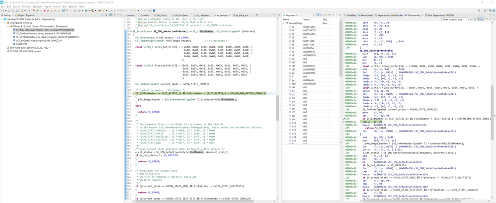

Right now I'm struggling to get normal debugging operation. I did break into SE_IMG_SetActiveFwState, but then I cannot step through it normally and the breaks jump all over the place. I'm confident I can at least find the source of the bug if I can debug. So I'm going to try some more things to hopefully get debugging sorted. If I can't I will make a detailed description how I setup debugging, perhaps you can then tell me what I'm doing wrong.

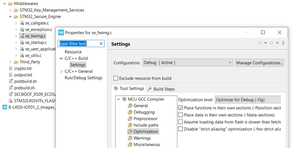

Here are main things to do
1) Change compiler option for se_fwimg.c
0693W00000QKT0OQAX.png2) Rebuild SECoreBin Project
3) Clean and build SBSFU project

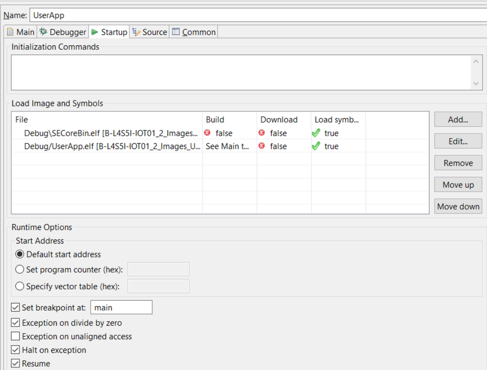

7) In main debug tab you can disable autobuild
8) go to startup tab, add SECoreBin and disable download:
0693W00000QKT2FQAX.pngThat's it !
In debug session you should get something like:
0693W00000QKT59QAH.pngYou can check with assembly window that code is well aligned with instructions. This is an important if you are not 100% sure.
Then you can step in the code, and with debug optimization of this part you should follow the code order.

I did a fresh install of CubeIDE 1.8.0 and SBSFU 2.6.0 builds without problems. So I tried debugging the default userapp and could not get that to work (the debugger simply exited after starting mentioning Break at address "0xfffffffe" with no debug information available, or outside of program code).
However I did manage to get the debugger running for my own app, and I did get it to break in SE_IMG_GetActiveFwState() but within that function is breaks at points were there are no break points and jumps seemingly randomly through the lines.

Regarding debug configuration. You added SBSFU in the picture.
To make things work with also SBSFU, the SECoreBin.elf should be in first place.
One possible reason for the issue you are facing (step debugging is going in random places) could be related to your USB cable or intermediate USB Hub.
