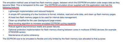

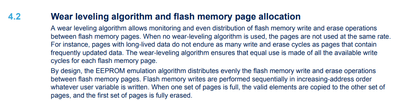

- The EEPROM emulation library X‑CUBE‑EEPROM implements already the wear leveling:
AN4894 "How to use EEPROM emulation on STM32 MCUs"

Thank you for the answer. I have already taken a look at X-CUBE-EEPROM. It doesn't seem to be working for my case because I need data to be written directly to be resilient to a power loss. The answer one of your colleague gave me was that a page is never fully written until it is completely full in RAM, which then triggers a page transfer.
Ok. need to separate questions here.
In that case you need to rework the algorithm to fit your needs. But that will definitely increase the Flash wearing.
Better to keep the EEPROM emulation algorithm implementation in the other discussion in this link.
