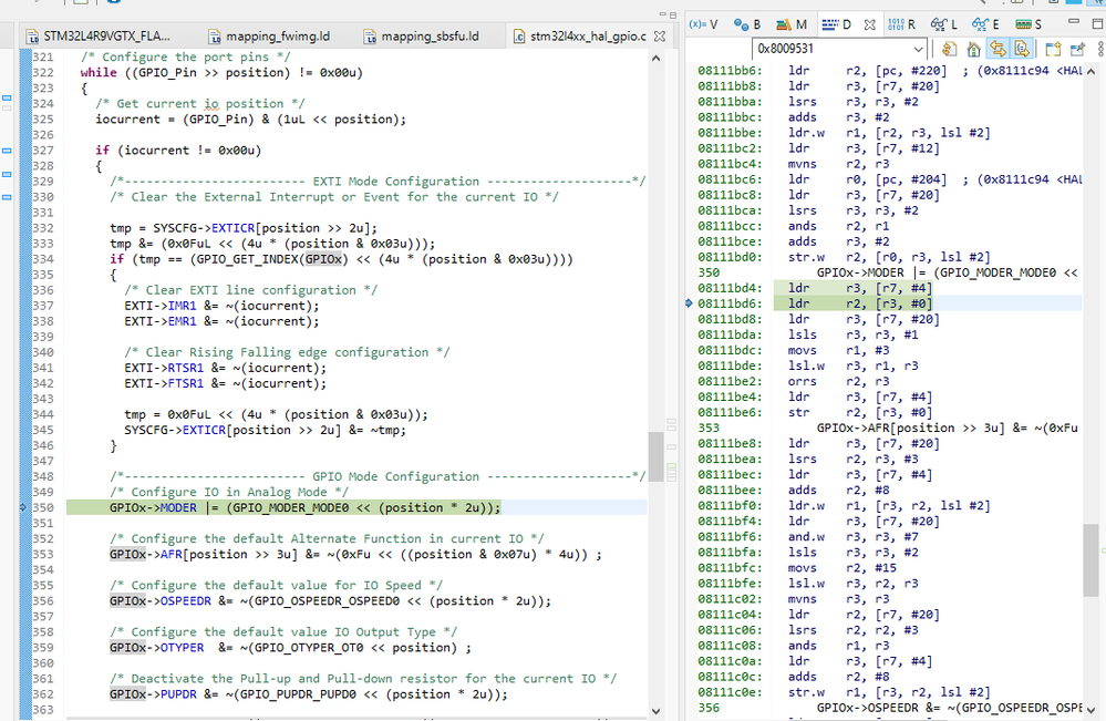

I am almost finished integrating the SBSFU into my project. I can run the SBSFU and user app and update the processor, STM32L4R9VITx, successfully while no protections are enabled. When I enable firewall protection it boots into my application but fails on the first write to a special function register. The SBSFU restarts with a firewall reset detected and retries the application.
My application uses FreeRTOS and the freeRTOS SVC and PendSVC handlers.
Any ideas as to why I cant write to the SFR's?
SBSFU Linker files and pictures of the debugger instructions below.

Fred
maybe a first thing to verify is that your application does not try to reuse the SRAM protected by Firewall:
  1. /* SE stack is placed 1st in RAM, stack overflow does not write on other RAM area */
  2. __ICFEDIT_SE_region_RAM_start__ = 0x20000000;
  3. __ICFEDIT_SE_region_RAM_stack_top__ = 0x20000400;
  4. __ICFEDIT_SE_region_RAM_end__ = 0x20000FFF;
The RAM in your application must start after this protected area:
define symbol __ICFEDIT_region_RAM_start__   = __ICFEDIT_SE_region_RAM_end__ + 1;
This is a first point to verify.

Hello @RBurg.2​,
STM32L4+ family has an issue with firewall implementation that is a bit tricky.
Errata sheet describes issue.
I would suggest starting from STM32L5S5 project memory setup provided in the SBSFU package.
This chip is used for more complex secureboot setups using KMS and STSAFE but you should be able, at least to start from the same RAM memory mapping which is key.
There are some comments in linker file that can help you understand the limitations.
Best regards
Jocelyn
Fred
@Jocelyn RICARD​ : yes, can be this indeed.
@RBurg.2​ : you can try to confirm this by not using SRAM1 (use SRAM2 and SRAM3 for your application) or you can implement a first fetch into another RAM before starting your application.
RBurg.2
Thank you both for taking a look. It looks like that L4 firewall issue. I found this firewall issues post which you had posted the affected memory regions. Unfortunately, I use most of the RAM as double frame buffers with touchgfx so I don't have an option to only use SRAM2 and 3.
I did have some success by configuring my application ram (128kB) to start in SRAM3 (0x20041000) and placing one frame buffer at the start of SRAM1 after the SE region and the other at the end of SRAM3. Interestingly, in this configuration my application booted (expected), and even ran with a bouncing line test screen and basic screen transitions, but cover style screen transitions often caused a firewall fault (and they are my main transition type).
This has got me thinking that the full SFU firewall is overkill as I only need to do encrypted updates and protect from app code readout. Maybe implementing MPU protection for just the cryptography key would be a better option... What do you think?

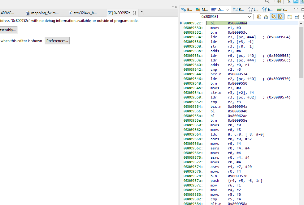

RBurg.2
Hi @Fred​
Today I had some time to test your suggestion of not having the firewall protect RAM. Interestingly I am getting a firewall reset on touchgfx cover transitions, same behavior as when I arranged my RAM so that only the framebuffer sections overlapped with the problematic RAM areas, frame buffer 1 - app ram - frame buffer 2. So it looks like full firewall protection might work if we can nail down this reset in touchgfx issue...
I disabled firewall in RAM by setting the init structure volatile segments to zero in sfu_low_level_security.c. My code boots into the application with the app ram in the problematic area then 2 frame buffers after).
  FWALL_InitStruct.VDataSegmentStartAddress    = 0;
  FWALL_InitStruct.VDataSegmentLength          = 0;
I tried to look into the cause of the reset, but without an interrupt to break on it is hard to nail it down. It isn't explicitly the cover transitions as some of them work every time, some are 50/50, and some always fail. When I step through the screen transition that it happens consistently on (breakpointing on view setup functions and high rate OS tasks, faster than screen refresh), the reset does not occur, and once the transition is complete it is stable. Do you have any suggestions on how to debug these firewall resets?
