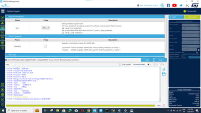

Hello everyone,
I'm experimenting PCROP activation on stm32h743 following this ST-tutorial: https://youtu.be/7Wr90XFA8_Q?si=tDpqUtMdin9Oyn-P
The activation works fine but i cannot disable PCROP using CubeProgrammer.
I did a RDP1 to RDP0 regression with DMWP1 checked but the PCROP is still active
After RDP regression i can se that the unprotected flash are is erase:
But not the protected one:
I can also not change the option bytes anymore, even RDP0 to RDP1 does not work
How can i recover from this situation ?

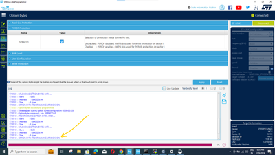

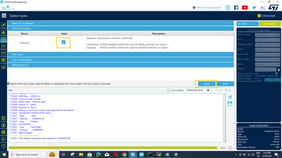

Enable and Disable the SPRMOD check box
ENABLE the SPRMOD:
Step1: Connect the MCU via JTAG/SWD
Step 2: Open the STM32CubeProgrammer or Download the STM32CubeProgram- Link: https://www.st.com/en/development-tools/stm32cubeprog.html

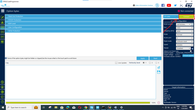

Step 3: Open STM32CubeProgrammer and press the Connect button.

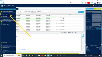

Step 4: Go to Option bytes
Step 5: Check the SPRMOD
Step 6: Successfully Enable the flash protection

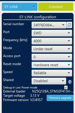

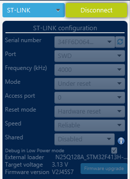

Disable the SPRMOD:

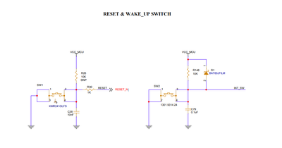

Step 1: MCU has RESET switch (SW 1). Press the Switch (Hardware Reset Switch)
Step 2: Disconnect the ST_Link
Step 3: Change the Mode to Under reset and Change the Reset mode to Hardware reset.

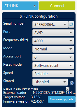

Step 4: After Connect the MCU via ST_Link

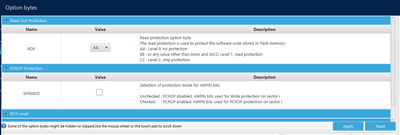

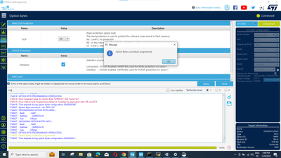

Step 5: Change the RDP from AA to BB
Step 6: Click Apply

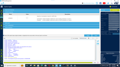

Step 6: Change RDP to AA and Uncheck the SPRMOD
Step 7: Click Apply
Step 8: Finally Disconnect and Connect the MCU for checking process.
