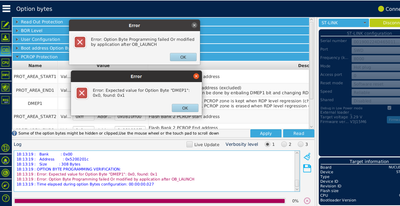

Hello everyone,

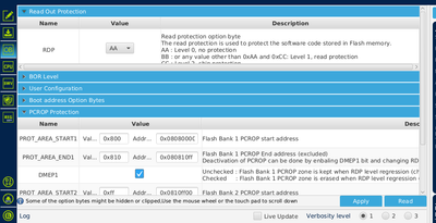

I'm experimenting PCROP activation on stm32h743 following this ST-tutorial: https://youtu.be/7Wr90XFA8_Q?si=tDpqUtMdin9Oyn-P
The activation works fine but i cannot disable PCROP using CubeProgrammer.

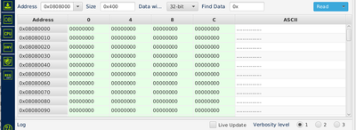

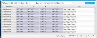

I did a RDP1 to RDP0 regression with DMWP1 checked but the PCROP is still active
After RDP regression i can se that the unprotected flash are is erase:
But not the protected one:
I can also not change the option bytes anymore, even RDP0 to RDP1 does not work
How can i recover from this situation ?

Jocelyn RICARD
June 4, 2024
Hello @aco990 ,
Try to do a power on reset (unplyg and replug the board basically) and connect under reset.
If it does not work, please dump the option bytes here using programmer CLI
Best regards
Jocelyn
aco990Author
June 5, 2024
Thank you @Jocelyn RICARD ,
the power on reset and connection under reset doesn't work.
could you give an example on how to dump the option bytes using programmer CLI. I am not familiar with programmer CLI and don't want to brick my board.
Best regards

PROGRAMMING OPTION BYTES AREA ...
 Bank : 0x00
 Address : 0x5200201c
██████████████████████████████████████████████████ 100%
UPLOADING OPTION BYTES DATA ...
 Bank : 0x00
OPTION BYTE PROGRAMMING VERIFICATION:
Option Bytes successfully programmed
Time elapsed during option Bytes configuration: 00:00:04.561
So, could you please try using same commands an show the traces?
Best regards
Jocelyn
