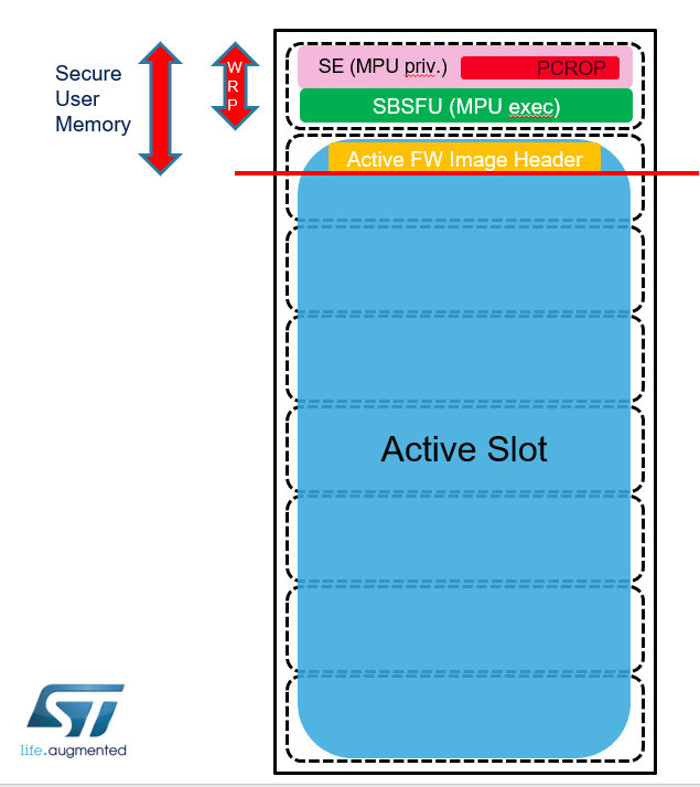

is ACTIVE SLOT Header protected ??
SPati.7
From SBSFU examples, with default SECUSER memory setting except reading from OB registers, it is only protecting SBSFU area alone.
Are we need to protect SBSFU + ACT_SLOT HEADER (1024 Bytes for H7) area as well right ??
So what is your recommendation on protection of HEADER ??
Ok, there is indeed a bug.
A change made for H7 devices with non-contiguous headers has been propagated erroneously to all H7 devices.
Will be better with:
#define SFU_SEC_MEM_AREA_ADDR_END ((uint32_t) (SlotHeaderAdd[SLOT_ACTIVE_1] + SFU_IMG_IMAGE_OFFSET - 1U))
in:
Firmware/Projects/NUCLEO-H753ZI/Applications/2_Images/2_Images_SBSFU/SBSFU/Target/sfu_low_level_security.h
Sorry for any inconvenience.

It protects also the active slot header:
Fred
When this is called:
SFU_MPU_SysCall((uint32_t)SB_SYSCALL_LAUNCH_APP, SlotStartAdd[SlotNumber] + SFU_IMG_IMAGE_OFFSET);
Can you still access the active slot header ?
Fred
Reading the code, I have a doubt too...let me check further.
@Fred​  To launch the application, we are giving right address by passing SlotStartAdd[SlotNumber] + SFU_IMG_IMAGE_OFFSET. But question is on configuring the secure user memory protection.
From examples, i didn't see that we are applying secure user memory protection to ACT_SLOT Header part.
So, as you mentioned, we should protect ACT SLOT HEADER as well, while configuring through OB, right ??
Yes, the active slot header is a sensitive piece of information, it must be protected otherwise we cannot trust the authenticity and integrity checks.
So, from a design perspective, it is clear that it must be protected.
Now, when looking at the latest implementation, I think the size we protect is too short.
I'm trying to clarify it with my colleagues.

Here I want to cross-check with my colleagues if I misunderstood something for the H7 about the active slot header protection.
The package is still evolving and I am not working on it any more so it may be a valid update compared to what I knew.
I'll keep you posted.
in:
