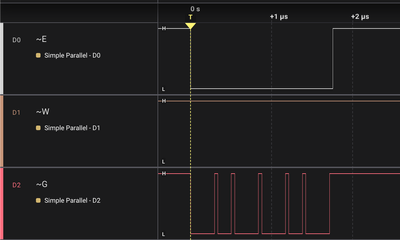

1. in my example, HAL_SRAM_Read_16b works correctly. ~E and ~G are triggered, and data is read correctly.

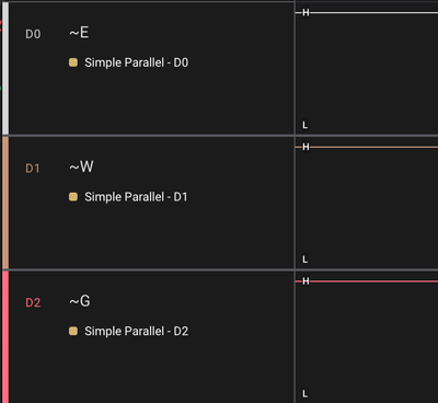

2. in my example, HAL_SRAM_Write_16b does not trigger either ~E, nor ~W. Writing happens (can see it in Memory View in STM32CubeIde) but it is not actually saved in the MRAM. Therefore, data is lost in the next reset of the uC.

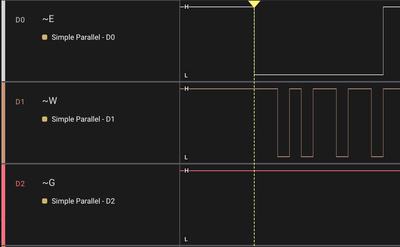

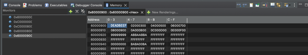

3.  Surprisingly, if I open a Memory View in STM32CubeIde and write in memory "by hand", ~E and ~W get triggered (correct functionality!).
All examples give HAL_OK as result. I have two questions regarding this:
  1. How come Memory viewer works correctly but calling the HAL functions does not trigger the ~W and ~E in the memory? How does Memory Viewer works for external mapped memories?
  2. What configuration is needed for FMC to work with my MRAM (SRAM memory)?

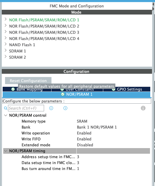

FMC config:

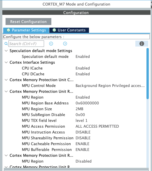

MPU config:

Best answer by mƎALLEm
For this kind of issue/behavior, start by disabling the cache either by using MPU or just do not enable it at your program start.
2 replies
mƎALLEm
mƎALLEmBest answer
January 28, 2025
SOgal.1
SOgal.1Author
January 28, 2025
Thank you very much @mƎALLEm . Removing those two lines solved the problem:
 /* Enable I-Cache---------------------------------------------------------*/
 //SCB_EnableICache();
 /* Enable D-Cache---------------------------------------------------------*/
 //SCB_EnableDCache();
 A question remains: Why does this affect the FMC and prevents the activation of the data writing?
