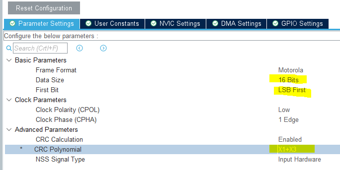

How do I calculate the SPI CRC-16 in C? I have an STM32F429 sending me SPI data.
These are the SPI settings:
0693W00000NrJmMQAV.pngHow do I implement a CRC-16 check implemented in C (not using STM32)?
It is 16-bit data with LSB first. Polynomial X1+X3

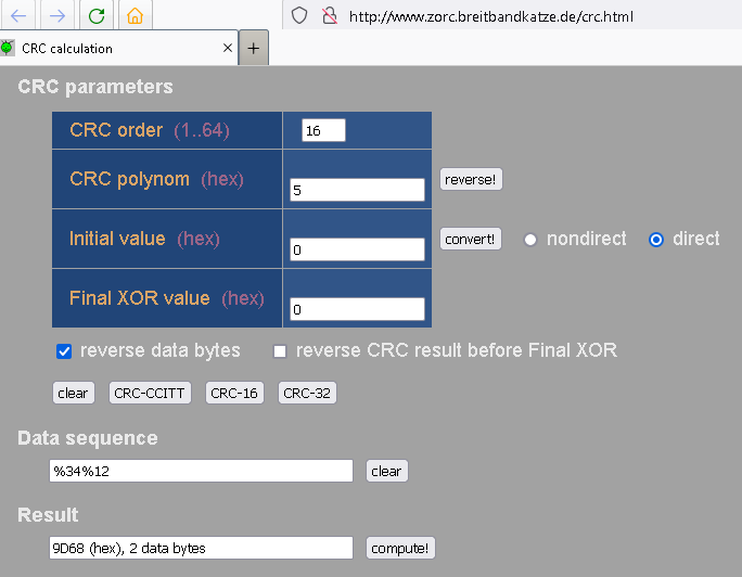

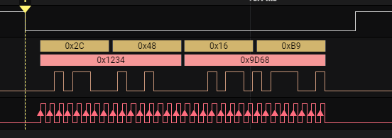

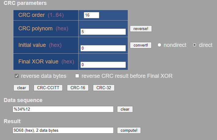

I tried your example with polynomial 5, I got CRC = 0x9D68 on my logic analyzer and the same on the CRC calculator page:

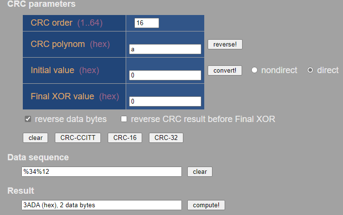

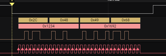

0693W00000NrRYwQAN.png0693W00000NrRZ1QAN.pngBut when I change to polynomial 10 it doesn't work. I got CRC = 0x1692 on my logic analyzer but 0x3ADA on the CRC page:

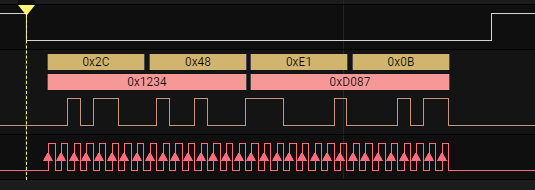

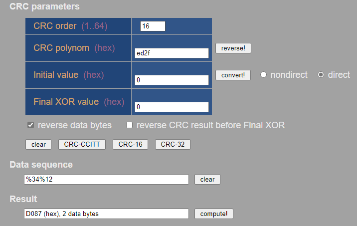

0693W00000NrRZLQA3.png0693W00000NrRbHQAV.pngI tried it also with another polynomial 0xed2f and that one worked also. Got CRC = 0xD087 on the logic analyzer and on the CRC page:

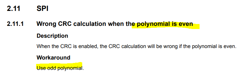

0693W00000NrRbRQAV.png0693W00000NrRbbQAF.pngMy theory is that the CRC unit has a bug when the lower bit in the polynomial is not set to 1?
I have also tested the CRC in Python and got the same results as on the CRC page.
I found this later:

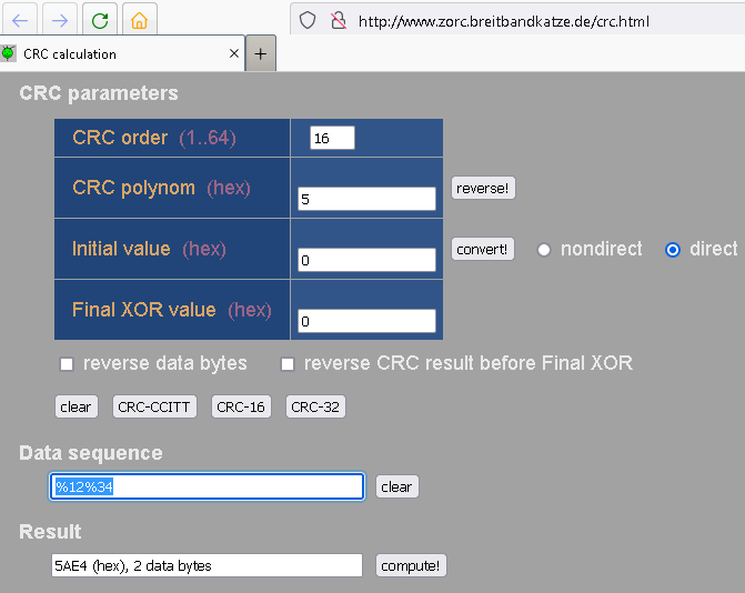

compare TXCRC=0x5ae4 to calculation on web calculator:
0693W00000NrMY3QAN.pngNow let's try the same thing just LSB first:

Note, that now we had to reverse both bit order and bytes order (the web-calculator feeds byte-wise):
I found this later:
