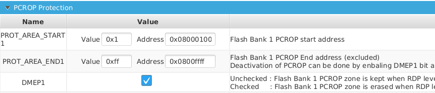

> PCROP regions are 0x100-byte aligned and possibly STM32CubeProgrammer incorrectly displays 0s for unsuccessful read accesses.
PCROP regions are definitely 0x100-byte aligned (see screenshot below).

‎2021-05-26 5:53 PM
Your STM32CubeProgrammer screenshot shows PCROP enabled and starting at 0x8000100, and explains the reads from 0x8000100 being incorrect.
For recovery, perhaps try mode "Under Reset" and Reset mode "Hardware reset", connect and then "erase fill chip flash memory". If that doesn't work, you might try individually disabling whatever protections are set in the OBs.
Docs for the STM32CubeProgrammer are at https://www.st.com/content/st_com/en/products/development-tools/software-development-tools/stm32-software-development-tools/stm32-programmers/stm32cubeprog.html#documentation.
If none of the above works, you may find the earlier STM32 ST-LINK Utility tool at https://www.st.com/content/st_com/en/products/development-tools/software-development-tools/stm32-software-development-tools/stm32-programmers/stsw-link004.html.
‎2021-05-27 3:37 AM
The PCROP should have been disabled and I believe it is the reason behind my problem.
I had tried already to connect with the "Under Reset" mode as I saw in other threads that it could be a solution in some cases. I also retried now, but still with no success. I am also unable to modify any of the OBs when I am in hot plug mode (which is the only mode in which I can connect to the board at the moment).
I also switched back to a Windows distribution to download the earlier ST-LINK Utility tool you suggested. Unfortunately, I obtain the exact same outcomes than with STM32CubeProgrammer. That is (1) I am only able to connect to the board using the hot plug mode, trying to connect in other modes yield an error and (2) in hot plug mode I am unable to perform a full chip erase or to modify any of the OBs.
I ordered a new board as I am out of ideas on how to recover this one and I don't want to take more of your time. I will be more careful with the next board. Your advice in your first reply will definitely help me, I will select it as best.
Thank you a lot for your time and advice.
‎2021-05-31 6:19 PM
Not sure if you've a problem with SWD reset.
Not sure if STM32CubeProgrammer's mass erase does proper protection removal first.
If you can connect, you might try manually removing protections per RM044 section 4.3.10 FLASH erase operations and other places.
@Remi QUINTIN​, you've expertise with STM32CubeProgrammer and option bytes. Could you assist please?
