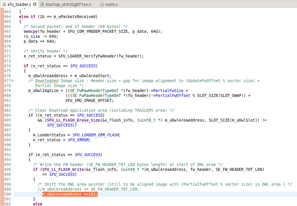

‎2021-08-31 6:12 AM
I just encountered the same issue with minicom, and MINICOM_YMODEM definition.
After debugging a bit, I noticed that the m_uDwlAreaSddress doesn't add the rx bytes correctly.
There are a few ways to address this, but the fastest way is to only take into account the rx header size (192 bytes), not the entire SE_FW_HEADER_TOT_LEN (320 bytes).
Another way would be to actually wait for the entire 320 bytes of the fw_header[] to be received, and then write it in Flash.
The following bytes between the header and the actual image are ignored anyway.
Hope that someone from ST will see this and fix it accordingly.
