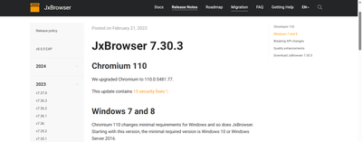

Hello @Piotr Romaniuk ,
Further to your comment, you mentioned that the Operating System is Windows 7 x64.
I suggest that you take a look at the RN0114 and you can notice that STM32CubeIDE is supported on Windows® 10 and 11, 64 bits (x64).
You do need to log to the ST account to download firmware packages but it's possible to download them manually from the ST website as zip files and then install them offline.
The minimal required version for the integrated JxBrowser is Windows 10 or Windows Server 2016.
Jxbrowser does not support windows 7 since 21/02/2023.

If I correctly understand: ST uses JxBrowser (commercial) library for having full support for HTML+CSS+JavaScript application in Java. myST support and acompaning functionality is written in JavaScript and web pages. Unfortunatelly JxBrowser requires Windows 10 at least.
It is a pitty that ST did not use Java for the application.
