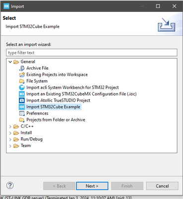

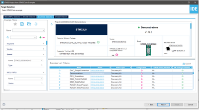

I suggest you to import 32L0538-Discovery Demonstration in this way:
1°) Start from STM32CubeIDE, and in Project Explorer select Import projects...
2°) In import Wizard choose STM32Cube Example, and click Next.

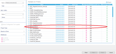

3°) In the example selector, set the Board filter to STM32L0538-DISCO, the search in the project list Demonstration project. Then click Next and Finish to copy the full project and libraries in your STM32CubeIDE workspace. The folder SW4STM32 will be migrated to STM32CubeIDE.
4)) After that, you can edit, compile and debug the Demonstration project with STM32CubeIDE.
if you check Project Properties, in Resource, Linked Resources, you will find the Path variables PROJECT_LOC is located in your workspace.
Let me know if it help you?
Best regards.
Romain
Yes I am able to compile and flash the device using the methods you have suggested above! Thank you very much. This is much easier than what is explained in the Migration guide document.

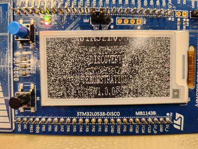

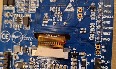

Unfortunately, despite the fact that I was able to compile the code and flash the board, I cannot get the Display to work properly. Perhaps this is due to damage flex cable as I have noticed a small tear at the end of the cable.
The small tear can be seen below:

AFAIK there are two different versions of the 'L0 Disco board, with different e-paper display. And old demo won't properly support the newer version.
Check the Disco's user manual, schematics, compare to the code you have.
[EDIT] https://community.st.com/t5/stm32-mcus-embedded-software/stm32l0538-disco-demo-program/m-p/82762

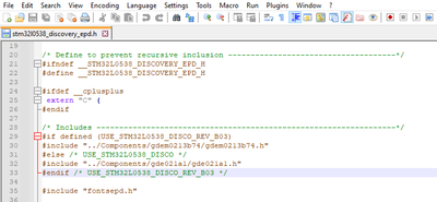

For the new revision of  STM32L0538-Disco RevB03, the epd display driver supporting gdem0213b74 is implemented in the STM32Cube_FW_L0_V1.12.2.
I suggest you to change the global define into project -> Properties -> C/C++ Build -> Settings -> GCC Compiler -> Preprocessor, and change USE_STM32L0538_DISCO by USE_STM32L0538_DISCO_REV_B03
I have replaced USE_STM32L0538_DISCO with USE_STM32L0538_DISCO_REV_B03 and now I can no longer compile the code

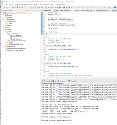

That is because I have followed RomainR. instructions provided above to create a project based on the STM32L0538Discovery Demonstrations which is probably based on the old version (not REV B03).
and I do not have the required driver source and header files for the new revision board
How can I create an example project that would be based on REV BO3? Is it available somewhere in the Example Selector?

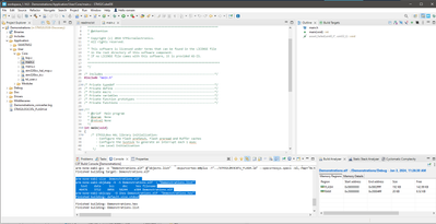

You get this linker error because  Drivers\BSP\Components\gdem0213b74\gdem0213b74.c is missing in the project
Drag "gdem0213b74.c" from location and link it in the project structure.
And exclude from build the "gde021a1.c" file.
See my Project explorer below, and the project will compile/link:
