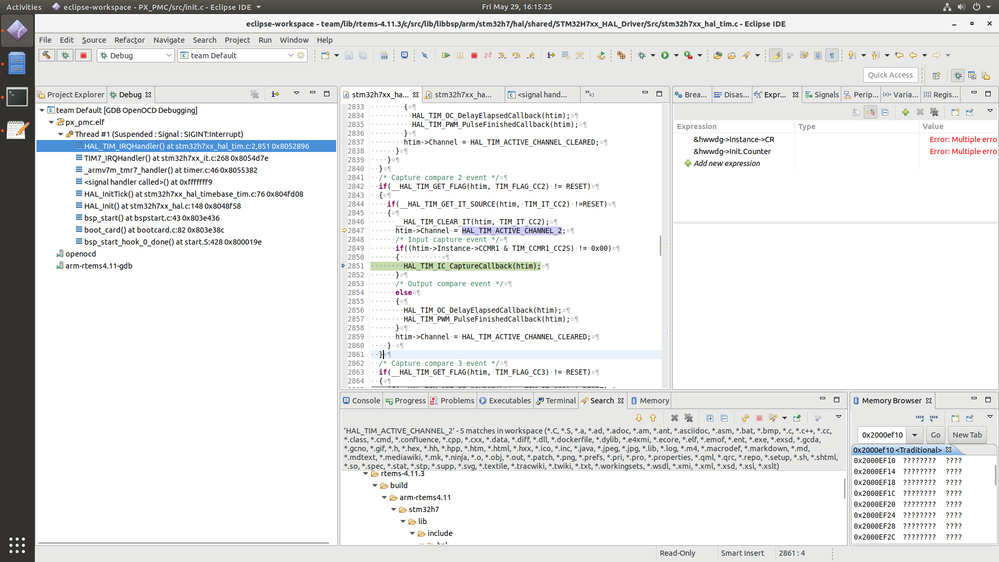

It seems like WWDG trigger reset, but after the reset system tick timer (tim7 ) getting capture interrupt and code looping in the interrupt. Please look the following attachments.
KVija

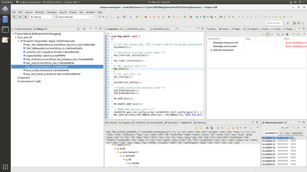

Please find the screenshot of the debugging information. After WWDG reset,TIM7CH2 interrupt is getting triggered until hard reset. After reset, TIM7CH2 interrupt is not triggering and application runs as expected.
I don't have a clue that why systick timer (TIM7 ) getting capture interrupt on WWDG reset.
