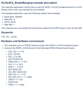

I'm new here and I'm new to programming with a big project.
I ordered a Nucléo F401RE with 2 Satel-VL53L8CX. My goal would be to detect right and left foot pose on a treadmill.

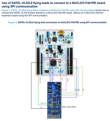

I would like to use examples but I don't understand why the connections contradict each other.
Where can I find the pin affiliation in the code ?
Is the VL53L8CX_SimpleRanging example best suited or STSW-IMG048 would be better for my case ?
https://www.st.com/en/embedded-software/stsw-img048.html#overview
THANKS
