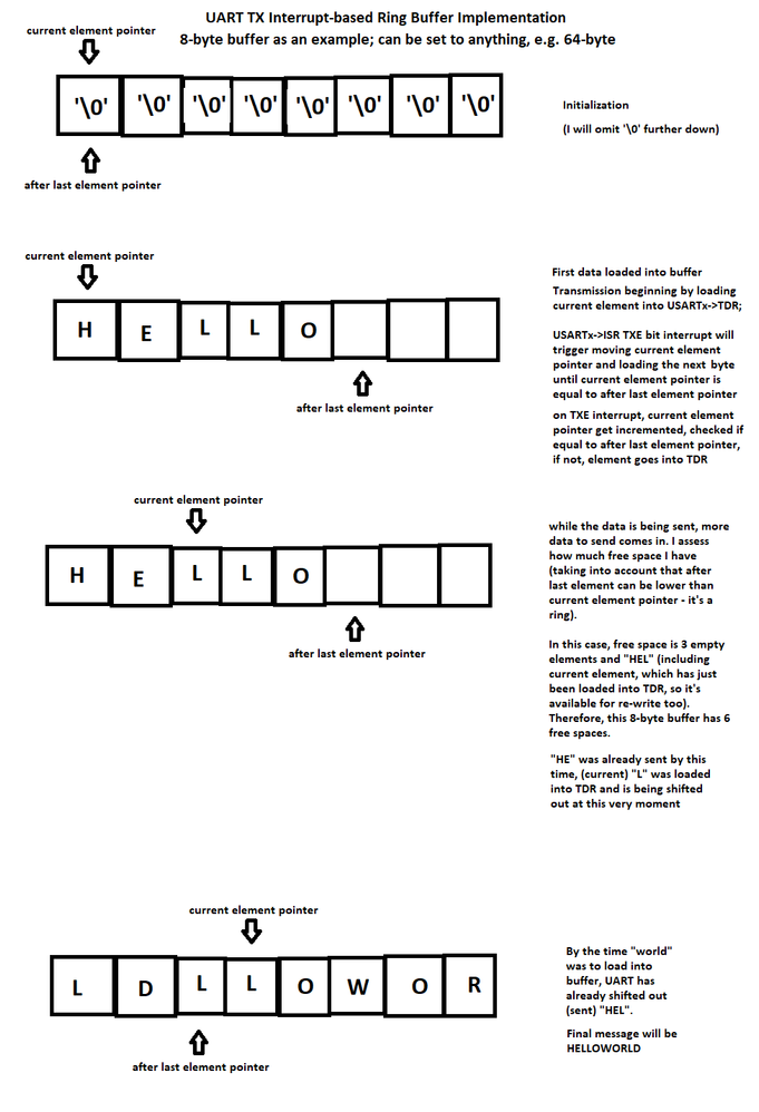

See the picture attached, top notch paint skills to explain how my uart tx ring buffer works.
In written form: I have an array that I use as a ring buffer for transmission. There is a pointer to the element that is currently being sent and the "after last element" pointer. When I reach the last element of array, I move to the beginning of the array. Hence, ring buffer.
Now, imagine I'm already sending something. At that moment I have another send request. What I do is I check how much free space my ring buffer has (buffer size minus how many chars are still waiting to be sent), and if it fits, it sits I write that new data into the buffer and move after last pointer accordingly. Basically, append it to what's already waiting to be sent.

As promised, here is my crude visual representation of what I'm doing. Not really that important for the question, but still.
