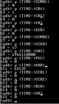

Thanks for reply!
I've checked all TIM2 register with openocd.
There are values for timer:
(TIM2->CCMR1) = 0 //Strange behavior
(TIM2->CCMR2) = 0 //Strange behavior
(TIM2->CR1) = 1
(TIM2->CR2) = 0
(TIM2->SR) = 0
(TIM2->EGR) = 0
(TIM2->CCER) = 17 // (10001) CC1E enabled, non-inverting, rising edge, CC2E enabled
(TIM2->CNT) = 1966110000
(TIM2->PSC) = 0
(TIM2->ARR) = 65535
(TIM2->CCR1) = 0
(TIM2->CCR2) = 0
(TIM2->DCR) = 0
(TIM2->OR) = 0
For GPIOA port:
(GPIOA->MODER) = 2820318474 // (10101000000110101010010100001010)
(GPIOA->OTYPER) = 0 // All push-pulls
(GPIOA->AFR) = {570425361, 17} // L(100010000000000000000000010001), H(10001) AF1
(GPIOA->BSRR) = 0
(GPIOA->IDR) = 51004 // (1100011100111100)
(GPIOA->PUPDR) = 1677742085 // (1100100000000000101000000000101) pull-up for PA0 and PA1
(GPIOA->OSPEEDR) = 201367562 // 1100000000001010000000001010
Result: some problem with setting capture/compare mode registers... Where the problem could be?
waclawek.jan
if CCMR1=0, it means, both CH1 and CH2 are output compare, i.e. the pins are turned to output.
You want them to be in input capture mode.
Read the TIM chapter and set the registers according to your requirements.

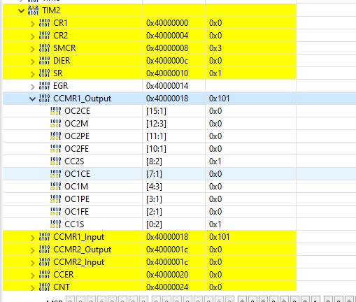

Thanks for advice. So, I disabled all tasks except odometry. I tried to directly set capture mod by writnig:
TIM2->CCMR1 |= 0x101U;
    TIM3->CCMR1 |= 0x101U;
But this register still holding 0x0 value during debugging session. Should I consider to change chip, because timer2 and timer3 circuitry burned?
MCU consumes around 170 mA with initialized timer and pins with alternate function and 30 mA with pins set to the input type.
Also, I've checked the same code on several F4 Discovery boards. Registers CCMR1 on all Timers (1,2,3) are staying the same with value 0x0.

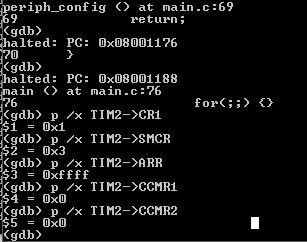

waclawek.jan
Then you do something wrong.
Write a minimal code, with nothing else but enabling timer clock, setting this register, and then infinite loop. Observe in debugger.
LL library (only main.c):
#include "stm32f407xx.h"
#include "stm32f4xx_ll_rcc.h"
#include "stm32f4xx_ll_system.h"
#include "stm32f4xx_ll_bus.h"
#include "stm32f4xx_ll_gpio.h"
#include "stm32f4xx_ll_tim.h"
static void rcc_config()
        /* Enable HSE oscillator */
        LL_RCC_HSE_Enable();
        while(LL_RCC_HSE_IsReady() != 1);
        /* Set FLASH latency */
        LL_FLASH_SetLatency(LL_FLASH_LATENCY_5);
        /* Main PLL configuration and activation */
        LL_RCC_PLL_ConfigDomain_SYS(LL_RCC_PLLSOURCE_HSE, LL_RCC_PLLM_DIV_8,
                                    336, LL_RCC_PLLP_DIV_2);
        LL_RCC_PLL_Enable();
        while(LL_RCC_PLL_IsReady() != 1);
        /* Sysclk activation on the main PLL */
        LL_RCC_SetAHBPrescaler(LL_RCC_SYSCLK_DIV_1);
        LL_RCC_SetSysClkSource(LL_RCC_SYS_CLKSOURCE_PLL);
        while(LL_RCC_GetSysClkSource() != LL_RCC_SYS_CLKSOURCE_STATUS_PLL);
        /* Set APB1 & APB2 prescaler */
        LL_RCC_SetAPB1Prescaler(LL_RCC_APB1_DIV_4);
        LL_RCC_SetAPB2Prescaler(LL_RCC_APB2_DIV_2);
        /* Set systick to 1ms */
        SysTick_Config(168000000/1000);
        /* Update CMSIS variable (which can be updated also
         * through SystemCoreClockUpdate function) */
        SystemCoreClock = 168000000;
static void periph_config(void)
        LL_AHB1_GRP1_EnableClock(LL_AHB1_GRP1_PERIPH_GPIOA);
		LL_APB1_GRP1_EnableClock(LL_APB1_GRP1_PERIPH_TIM2);
         * Initialization first encoder gpios
		LL_GPIO_SetPinMode(GPIOA, LL_GPIO_PIN_0, LL_GPIO_MODE_ALTERNATE);
        LL_GPIO_SetAFPin_0_7(GPIOA, LL_GPIO_PIN_0, LL_GPIO_AF_1);
        LL_GPIO_SetPinPull(GPIOA, LL_GPIO_PIN_0, LL_GPIO_PULL_UP);
        LL_GPIO_SetPinMode(GPIOA, LL_GPIO_PIN_1, LL_GPIO_MODE_ALTERNATE);
        LL_GPIO_SetAFPin_0_7(GPIOA, LL_GPIO_PIN_1, LL_GPIO_AF_1);
        LL_GPIO_SetPinPull(GPIOA, LL_GPIO_PIN_1, LL_GPIO_PULL_UP);
         * First encoder mode timer
        LL_TIM_CC_EnableChannel(TIM2, LL_TIM_CHANNEL_CH1 | LL_TIM_CHANNEL_CH2);
        LL_TIM_IC_Config(TIM2, LL_TIM_CHANNEL_CH1,
                         LL_TIM_ACTIVEINPUT_DIRECTTI |
						 LL_TIM_IC_POLARITY_RISING);
        LL_TIM_IC_Config(TIM2, LL_TIM_CHANNEL_CH2,
        LL_TIM_SetAutoReload(TIM2, 0xFFFF);
        LL_TIM_SetEncoderMode(TIM2, LL_TIM_ENCODERMODE_X4_TI12);
		LL_TIM_EnableCounter(TIM2);
        return;
int main() {
        rcc_config();
        periph_config();
		for(;;) {}
        return 0;
The same result here:
I will try to install CubeIDE and make the same on HAL
With HAL and STM32CubeIDE Timer 2 works fine. Though, the time of a foreign code refactoring coming... :worried_face: 0693W000003RChhQAG.png
Thanks for the significant support, and have a nice day!
Thank you for your support. I've generated code in CubeIDE for the LL library and copypasted it in my project. Now everything works fine.:grinning_face:
