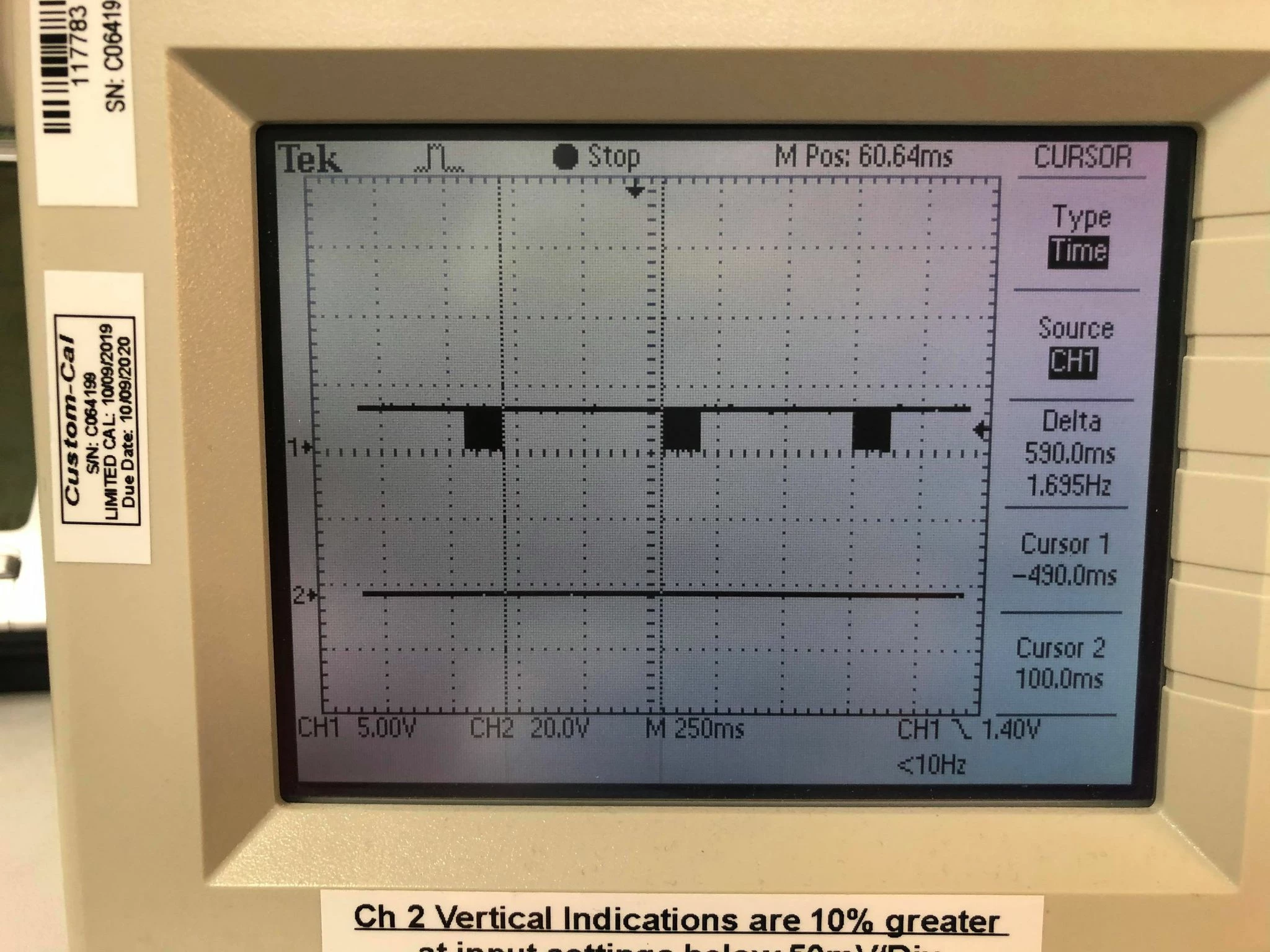

0693W000003RBXMQA4.jpgAt low duty cycle (like below 5%), the timer pwm stops periodically (see the attached picture). The higher the duty cycle, the smaller the stop period. Does anyone know why this happens?
For context, I am using the STM32F072 Discovery board. I use CubeIDE to generate the code with the timer setting as below:

Then in the while loop in main, I call
while(1)
 htim3.Instance->CCR1 = 799;
 HAL_Delay(200);
Thank you.
Sounds more likely to be a bug in the code than a hardware issue.

HRTIMER with PLL has restrictions on low/high duty cycles. Reread the datasheet and teh hrtimer section in the reference manual. If I remember right, you can not get shorter than the bus clock of the hrtimer.

I'd say, this is oscilloscope sampling/aliasing issue.

> My code is pretty simple. I have added the code in my question. Can you take a look at it?
The code that you posted seems fine to me. Presumably there's more code that you didn't show, since you don't start the timer anywhere in there.
I would be surprised if aliasing shows up like that on a scope, but it could explain the result. What is your PWM frequency and what is your scope sampling rate?
