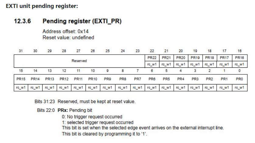

Why there are two pending registers for interrupt? ,e.g EXTI_PR and ISPR
YShko.1

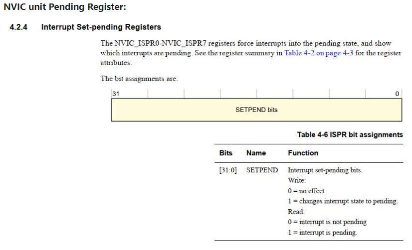

Why there are two pending registers for interrupt? One of them is EXTI_PR and other one is Interrupt Set-pending Registers(ISPR) which is in NVIC controller registers.?
What is the diffrence between them?
Thanks in advance

This is because EXTI from the ARM point of view is one of vendor-provided peripherals. It supplies several interrupt entries to NVIC. The NVIC is defined by ARM architecture.
​Note also that several EXTI interrupt sources can share one NVIC vector, so you'll need the EXTI register to identify and clear the source.
S.Ma
Principal
PR are just edge detectors that can be used without interrupts, in regular time interval, for example. Some of exti signal can go trigger interrupt, or become hw trigger signal without it...

To clear EXTI interrupt request, clear the flag in EXTI. NVIC ISPR registers are only used when generating the interrupts in software and normally there is no need to use NVIC ICPR - the requests in NVIC are cleared by NVIC hardware when the ISR is invoked.

The EXTI_PR register is read-only and it is used to indicate which external interrupts are pending, while the NVIC_ISPR0-7 registers are writable and used to force interrupts into the pending state.
Both registers are used to indicate which interrupts are pending, but the NVICI_SPR registers can also be used to manually set interrupts to a pending state.
