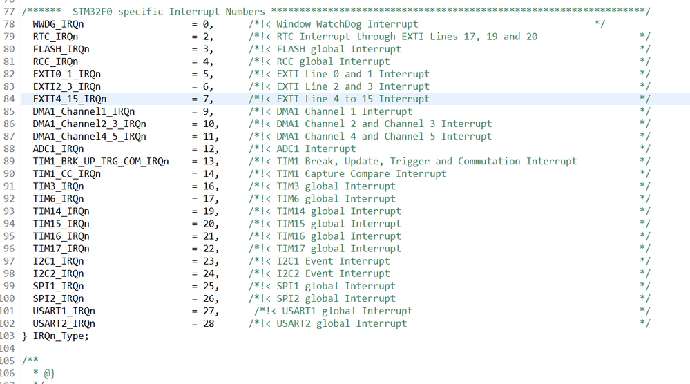

IRQn_Type is an enum, Here is a picture from stm32f030x8.h :
0693W00000Y92DQQAZ.pngas you can see in the picture I cant choose a specific line, only a vector, e.g EXTI4_15_IRQn which is coresponding to all the lines 4-15. so I dont really understand how can I use this function to a specific line?
thank you for your time!!
To clear one EXTI source you use __HAL_GPIO_EXTI_CLEAR_IT or call HAL_GPIO_EXTI_IRQHandler. No need to clear the NVIC interrupt, it should clear itself as soon as the EXTI drops its interrupt request.
