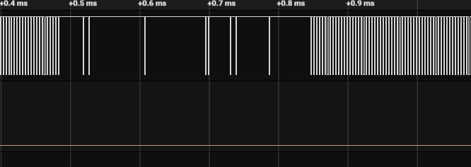

Stm32F0 TIM16 PWM not continuous
hdemi.1
0693W00000Y90r4QAB.pngPwm is not continuous My clock freq 20mhz
Where am i doing wrong ?

gbm
Principal
How many times do you cal this function in your code? Should be called only once during init.

AScha.3
try with lower pwm frequ. or check with a scope (to avoid sampling problem)
and show measurement.
