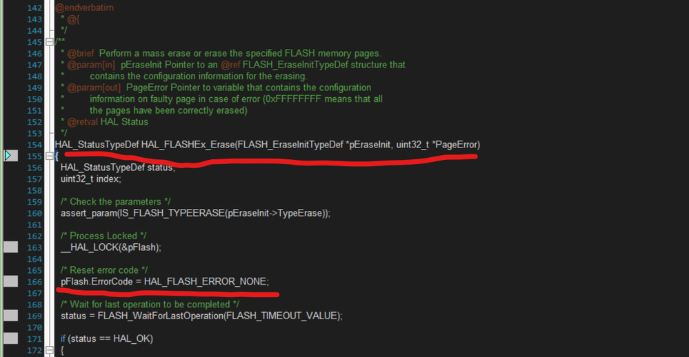

Hello everyone I try erase and write the flash of stm32g0b1cetx series. every time I try I got this error code from flash " pFlash.ErrorCode = 0x000000A0".
is anybody have idea what problem is here i try example code too.
I am totally beginner to stm32g0 series
this is my code

Bubbles
September 7, 2022
Hi @Ali110​,
what exactly is this pFlash.ErrorCode? I don't see this structure pointer defined in your code and neither it's from CMSIS.
If it's somehow linked to the FLASH_SR, then 0x000000A would mean attempt to program unerased flash.
What example did you try?
BR,

Ali110
Ali110Author
September 9, 2022
Hello @JHOUD
Thank you for quick answer, I try to write some important data on flash of stm32g0(I am using stm32g0b1 series) to update my device but when I try to store new data and erase old data from flash, I got the FLASH_FLAG_PGAERR ERROR, FLASH_FLAG_PGSERR ERROR. I am using this examples of stm32g0b1 for reference but still get some issue. Sometimes erase and write and happen and after the next try operation is failed. I don’t understand why this happen. Please help me to debug the problem why some time erase and write is complete and next try is not.
I am using the FLASH BANK 1
And starting address of bootloader 0800 0000 (i put bootloader at starting address of flash for my requirements).
End address of bootloader - 0800 1FFF
And starting address of data – 0800 1800
End address of data - 0803 FFFF
Erasing Method – page erase
@JHOUD​  what exactly is this pFlash.ErrorCode?
i got this variable in HAL_FLASH G0 header file. i put screenshot of function 0693W00000SuwZwQAJ.png
