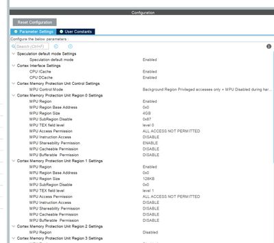

Hi everyone,
I have a problem with the Ethernet connection that I can't solve on the STM32H747I-DISCO board.
I followed Adam Berlinger's guide step by step (https://community.st.com/t5/stm32-mcus/how-to-create-a-project-for-stm32h7-with-ethernet-and-lwip-stack/ta-p/49308) and the Ethernet works for a while, but when I send messages on udp or start the ping, after a while it stops working.
can someone help me?, I've been trying to fix this problem for two months now but without success.
thank you very much in advance.

hii @magianf  could you share your configurations settings.
thanks for the reply jumman_JHINGA , this is my .ioc made with IDE version 1.18.1
if you need other files just ask me.

thanks for the reply, I'm trying to use NetXDuo, but I can't find a good example to map the H7 memories
Hi all,
is there anyone using NetXDuo on the STM32H747 micro that can help me with the CORTEX_M7 MPU configuration settings.
thanks a lot
