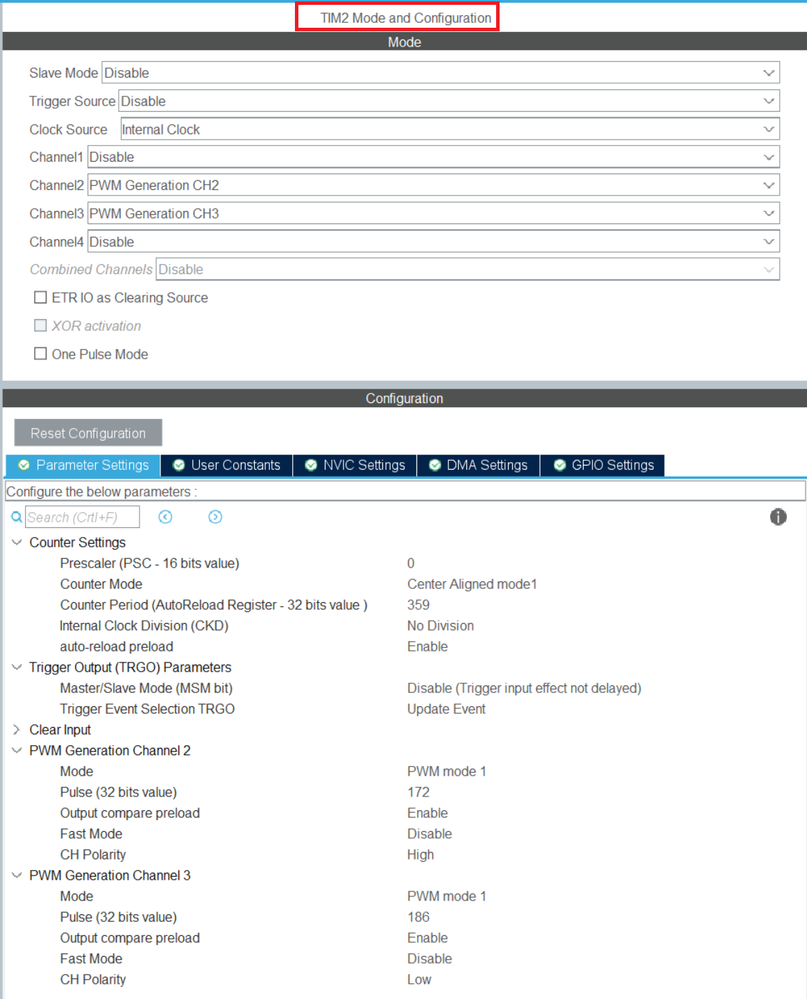

Hi! I'm using STM32 F301C8T for my LLC converter project. I have two MOSFETs switching at variable frequencies ranging from 80kHz to 400 kHz. Due to significant noise caused by switching, I need to time the output voltage measurement between the switches of MOSFETs.

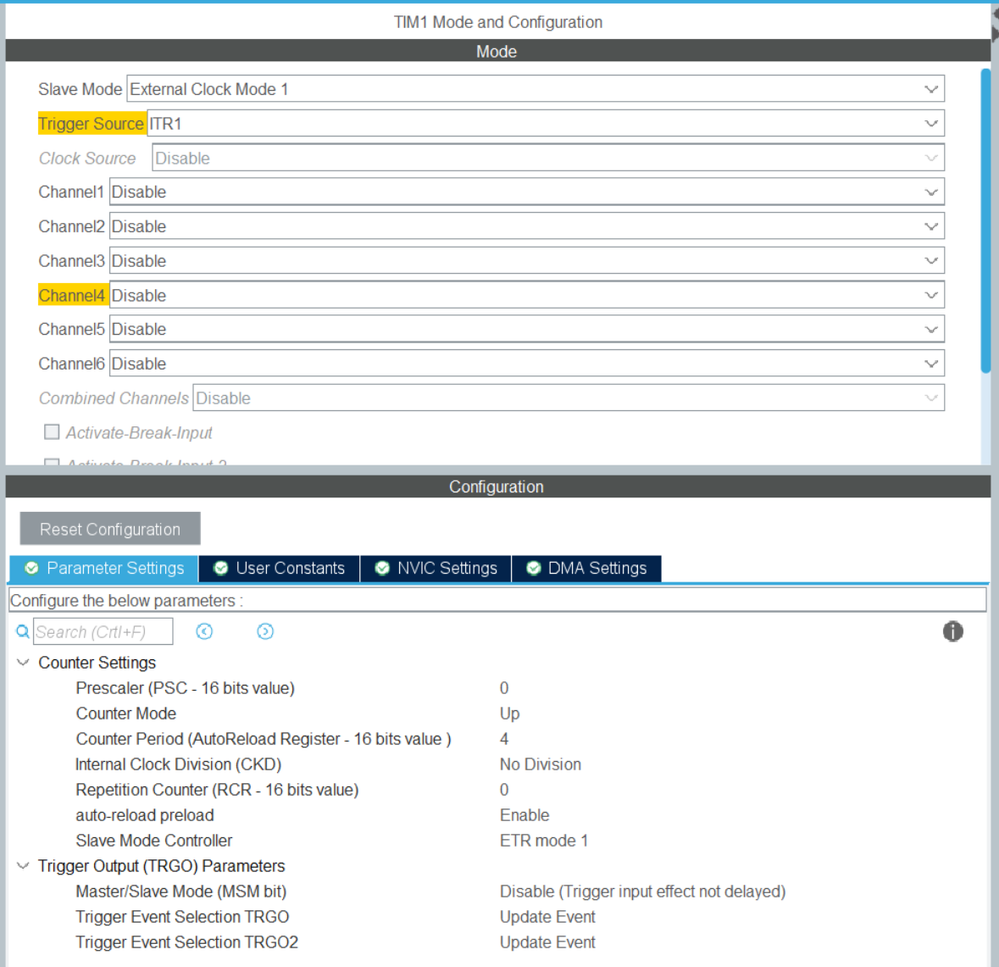

I use TIM2 for PWM to switch the MOSFETs and TIM1 to count output events of TIM2 (TIM2's arr = 4, meaning that every 5TIM2 overflows, TIM1 overflows as well). Using the debugger, I checked that TIM1 counts appropriately.

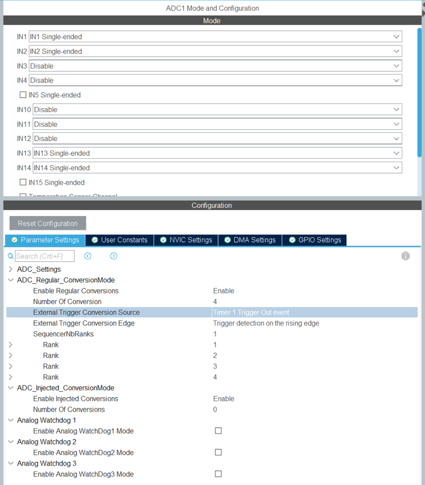

I set ADC conversion to be triggered by "Timer 1 Trigger Out Event," and it seems like the AD conversion is not triggered. (+using DMA in circular mode).
Can you guys please advise what I am doing wrong? I start the TIMs and ADC by:

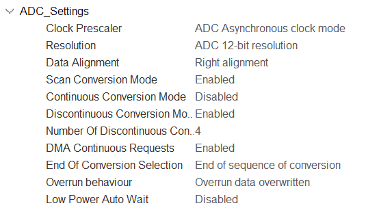

‎2023-05-05 5:27 AM - edited ‎2023-11-20 6:44 AM
Hi Amel, thanks, but this didn't solve the issue. I, however, managed to find a solution- my ADC setup in CubeMX was wrong. It should be as follows:
