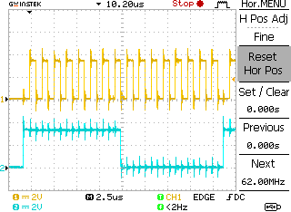

When I use SPI in polling mode, i found a weird thing. I have never met this before when I were using F1xx series chips.
The date size is set to 8-bit long and MSB first (SPIx_CR1=0x36C,SPIx_CR2=0x1700).
Here is the main code.
while(1)
SPI1->DR = 0XFF;
while(SPI1->SR & SPI_SR_BSY);
while(!(SPI1->SR & SPI_SR_RXNE));
temp = SPI1->DR;
This is the corresponding waveform.
Is the sentence ''SPI1->DR = 0XFF;'' a kind of ''16-bit access of SPIx_DR''?
When I replaced 0XFF with a uint8_t variable the waveform didn't change at all.
I also changed the optimization level to -O0, but it had no effect.
''Data packing'' is too inconvenient to communicate with some devices,like nRF24L01. Can anyone tell me how to read/write SPIx_DR in a 8-bit way like it is in F1xx series?
Thanks.
    What's the structure define it as being? Because it will use that to determine it.
    *((uint8_t *)&SPI1->DR) = 0xFF; // simple casting

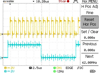

    Hi clivel,
    Thank you for your advise, it works!
    I also try to change the define of DR in the structure to uint8_t, it has the same effect. :D
    But I am still confused why ?SPI1->DR = 0XFF;? and ''*((uint8_t *)&SPI1->DR) = 0XFF ;'' show up in the same assembly statement.

    STR (Word) vs STRB (Byte)
