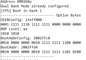

I allow to send this message after a long attempt to perform a switch bank on my STM32U385RG.
This is part of my code:

You can view some logs in attached files:
I can do the swap directly with STMCubeprogrammer but I cannot do it with code so i suppose that it's an error of configuration or code.

Sixela
i don't know how i can active or deactivate the CPU_IN_SECURE_STATE .
I had already deactivate all OptionBytes for security (TZEN,WRP,...) and i don't use the MPU actually
I have already converted the code from the example into a unified code, but it's not working either.
I think there may be something interfering with the exchange.
I don't know why perforrm the swapping is impossible for this one.
