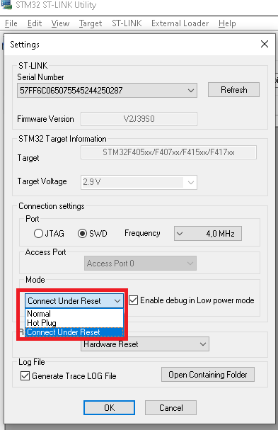

Checked with this code:
RCC->AHB1ENR|=RCC_AHB1ENR_GPIODEN;
GPIOD->MODER=0xFFFF;
This is a normal start mode

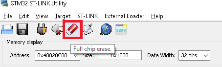

0693W00000NqPuAQAV.pngThis is a launch in Connect under reset mode
Registers are not set to the default value after a restart.
Only after erasing the entire chip, for some reason, the registers are set to the standard reset value.
0693W00000NqPuPQAV.pngAnd Connect under reset mode just helps you enter the chip with standard settings.
I thought that after each restart of the microcontroller, the bits from the "reset value" returned to the standard state.
As the reference manual shows, except for ports A and B, for the rest of the ports MODER reset value is zero. In the first image you are looking at the value after the firmware has modified it. In the second image you are looking at the value before the firmware has modified it. And in addition, when the respective peripheral clock is not enabled, the peripheral registers will mostly read as zero anyway.

>>I don't know at what moment exactly you looked at those values (especially in the first picture)
In the picture, where is the value 0000FFFF stored under the address 0x40020C00?
These two images are made with the same code on the microcontroller.
The only difference between these two pictures is that in the first picture I used Normal Mode.
And in the second picture I used Connect Under Reset Mode.
0693W00000NqPw6QAF.pngSoftware: STM32 ST-LINK Utility
The code on the microcontroller was:
These modes can be turned on and off as many times as you like. In Connect Under Reset Mode, only a TEMPORARY reset of register settings.
In normal mode, the register settings I saved with IDE are RETURNED AGAIN.
>>But one thing is for sure - the reset definitely resets the values to the default ones!
Pressing the reset button on my STM32F407 board? (This does not reset the registers to default settings.)
Soft reset also does not reset the registers to default settings.
As far as I understand Hard reset and Soft reset just help to replace the old code with a new one, I think a restart is more suitable than a reset.
I don't know of a way yet other than a complete wipe of the microcontroller to reset the registers to default settings PERMANENTLY.
If you meant Connect Under Reset, then yes, in this mode, the register settings are temporarily reset to the standard state.
