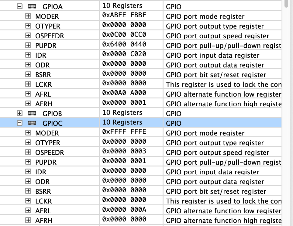

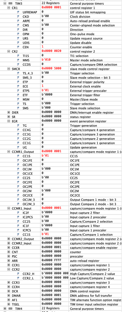

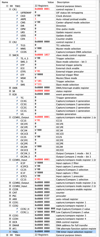

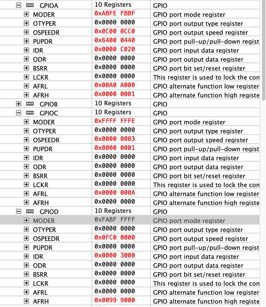

Hi Jan--thanks for the quick reply. Easiest way seemed to be to screenshot in ozone--I'm happy to provide a different format or add information.
ETR2 TIM3:
ETR2 GPIO:
ETR1 TIM3:
ETR1 GPIO:
