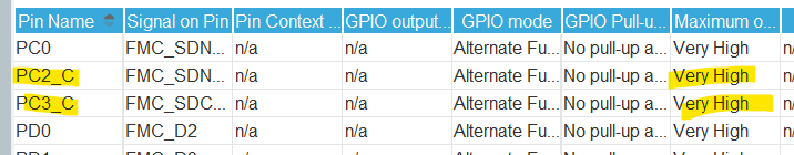

Seems that CubeMx isn't aware of this limitation.
Here you can configure Pxy_C pins for Ethernet, SPI, SDRAM, etc. and in all speed options including high speed.
IMHO the high speed option requires a drive strength >> 1mA.

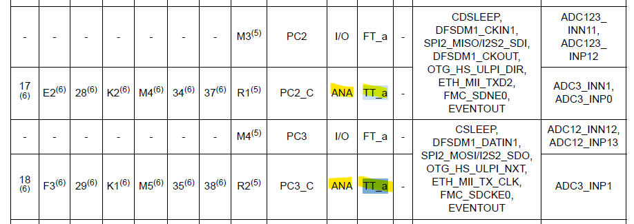

In DS12117 rev9 Table 8 Pxy_C pins have attributes ANA and TT_a but I cannot find a documentation regarding these attributes. Second, is there any information from ST avaliable regarding "boundary scan capable pins"?

for me, disabling the "High Speed" option or showing an extra column with the pin type "ANA" or "TT_a", as shown in DS12117 rev9 Table 8, whatever this type name exactly means, could have saved one or another from a board redesign.

Second, is there any information in the datasheets which pins are not boundary-scan-capable?

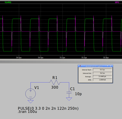

I fell into the trap to use these xx_C pins : used one xx_C pin as SPI/data to a small TFT ;
at first everything working fine, with HAL and about 4MHz clock ;  but display update bit slow;
then i tried direct write DMA->SPI and set clock to 24MHz ; very fast now, fine -- but only about some seconds !
Then nothing more coming to TFT...pin was dead. Hmmm....
Tried remap to use other pin , working fine again - and still does.
So i killed the tiny analog switch, that connects the pin here !  (1mA output load limit , afair.)
You can imagine these pins like a "normal" pin, with a very tiny resistor in series (about 300 ohms);
as long as you use the pin as input , no problem; as an output, at low speed and hi impedance load , no problem, as long as output current < 1 mA ; more load and its toasted .
So these pins might be used for SDRAM , if low capacitative load and low speed (maybe 4MHz).
I made simu, 300 ohms and 1mA -> 0,3mW max.
4MHz in 10pF load giving : 1mA rms , so its the limit.

I wonder why these pins can be configured as "High Speed" pins in CubeMx :(
