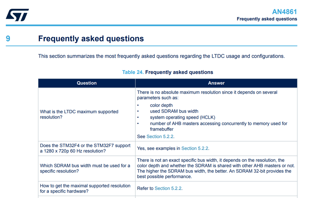

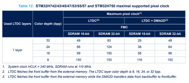

I have I project (STM32H743IIT6) and I want to know if it's possible to have use a display 1280x800 24bpp? if it's not possible can I still have a display with a resolution of 1280x800 but with les bpp? Can I use a different MCU STM32H757XIH6 or another?
Thank you
